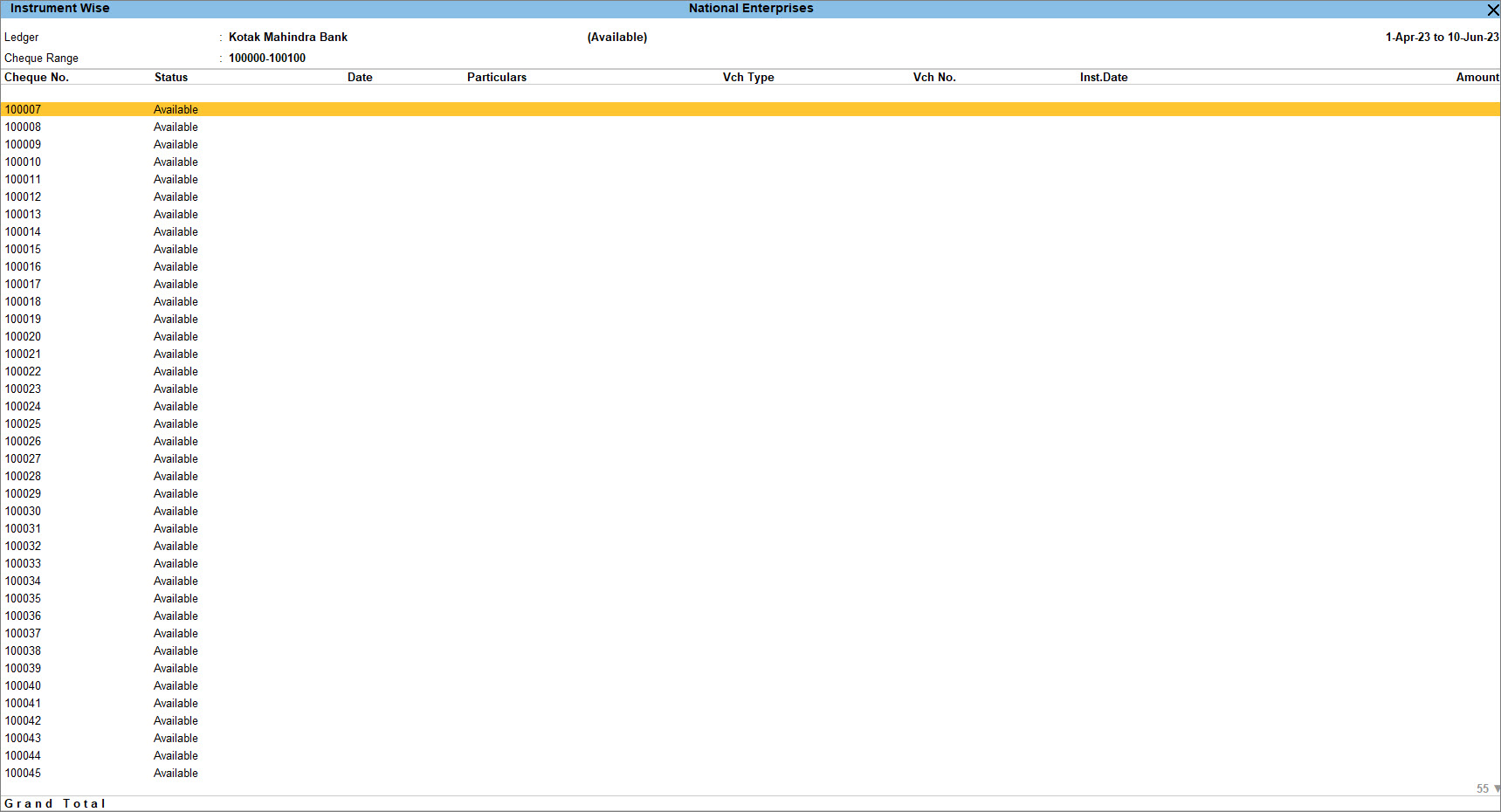

  1. Press Alt+G (Go To) > type or select Cheque Register and press Enter.
  2. In the Cheque Register screen, select the total number of Available Cheques with respect to your bank ledger and drill down to the Instrument Wise screen.
    Instrument wise
  3. Select any cheque by pressing Spacebar.
  4. Press Alt+S (Alter Status) to change the status of the cheque.
  5. Select Blank Cheque under Cheque Status to update the status of the cheque from Available to Blank.

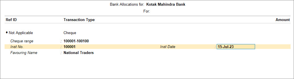

    2. Press Enter to skip all the fields. The Bank Allocations screen appears, with the Instruments details pre-filled.
      Blank cheque
    3. Press Enter to accept all the details in the Bank Allocations screen. The Voucher Creation screen reappears.

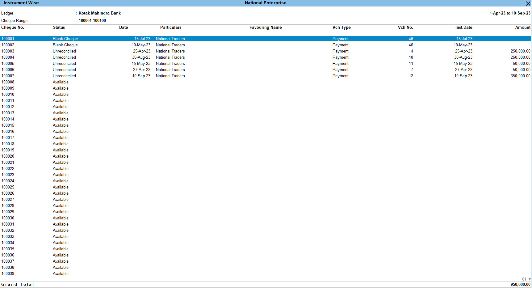

      The status of the Cheque No. 100001 gets updated to Blank Cheque.
View Blank Cheque in Cheque Register
  • Drill down from the Bank column to the Instrument Wise screen.
    You can observe that the status of Cheque No. 100001 now appears as a Blank Cheque.
    Instrument wise blank cheque
  • Drill down further to make changes to the voucher, if needed.
You can then convert the Blank Cheque to a normal cheque by drilling down to the Amount field in the Voucher Alteration screen and entering the value.
