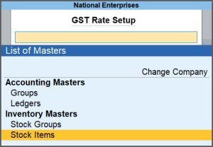

  1. Press Alt+G (Go To) > GST Rate Setup.
  2. From the List of Masters, select Stock Items, and press Enter.
    Let us consider Stock Items in this procedure.

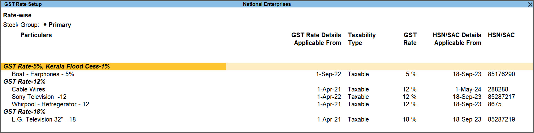

    The GST Rate Setup report appears, as shown below:
    GST-rate-setup-report

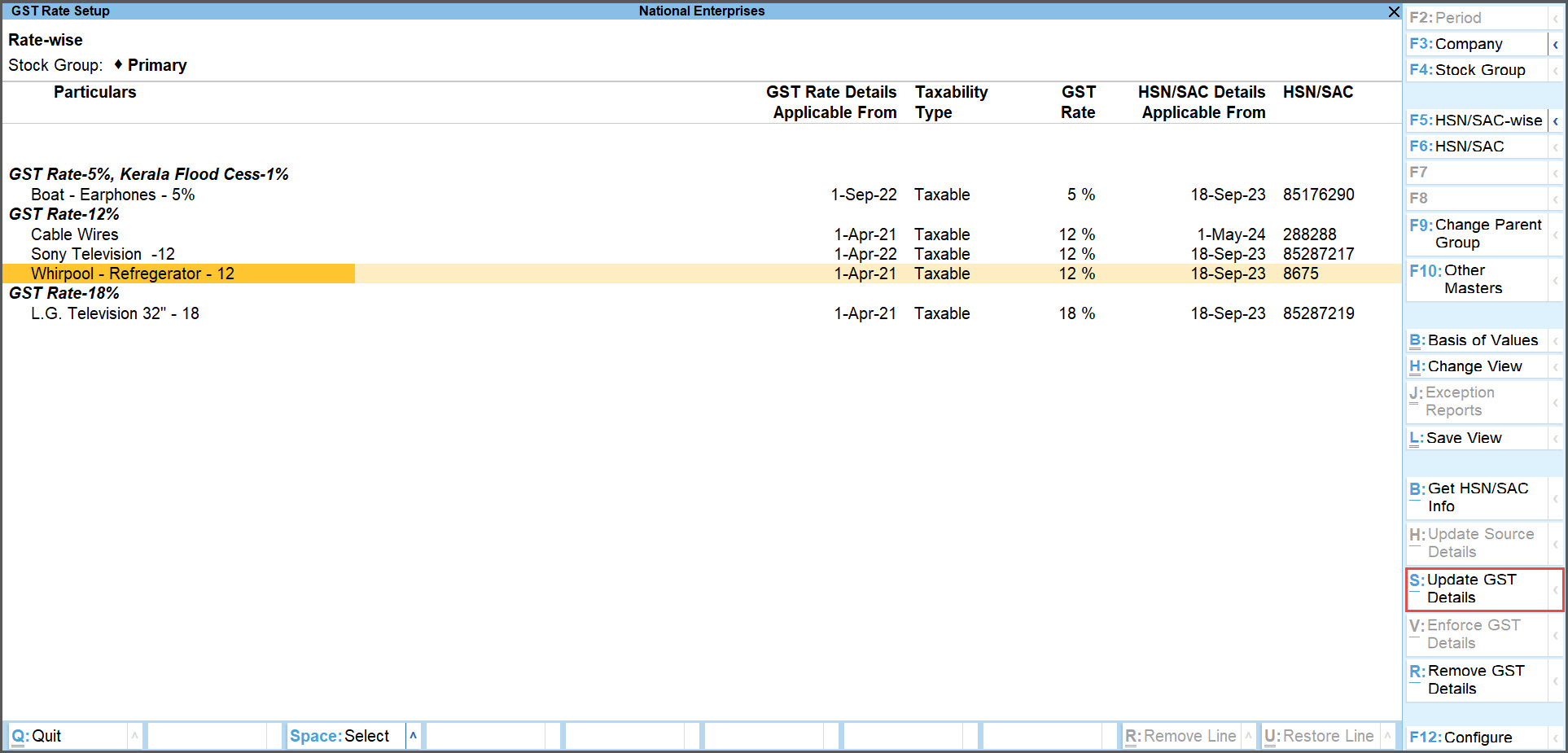

  3. Select the Stock Item for which you want to update the HSN, and press Alt+S (Update GST Details).
    update-gst-details
    As per your business needs, you can select multiple stock items by pressing Spacebar.

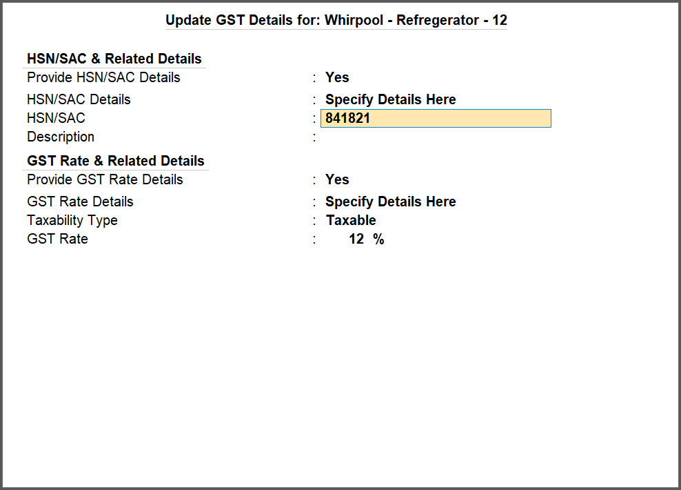

    The Update GST Details screen appears, as shown below:
    update-gst-details-for-whirlpool
  4. Specify the relevant HSN/SAC details.
    1. In the HSN/SAC & Related Details field, select the Specify Details Here option.
    2. Enter a valid HSN that is a minimum of 6 digits, for the selected Stock Item.
      Note: You can know about HSN/SAC details, as needed, by pressing Alt+H (HSN/SAC Details (History)).

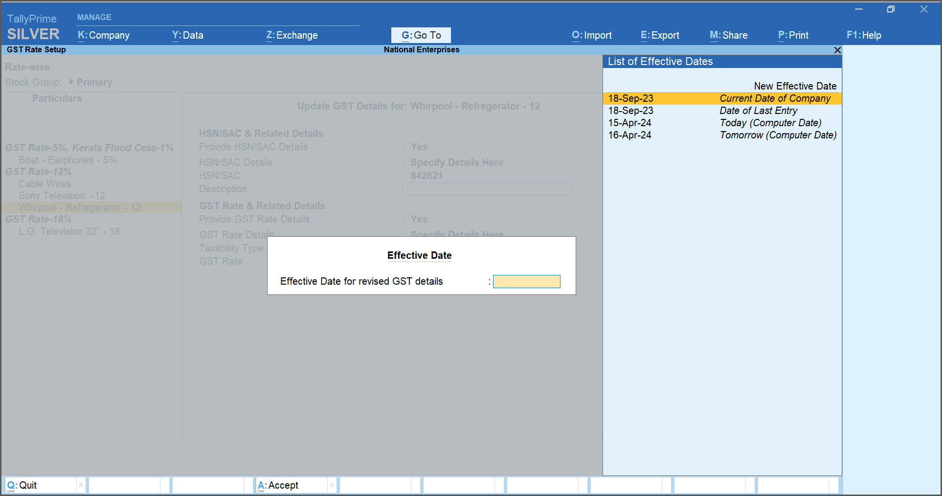

    3. Press Enter to provide the Effective Date for revised GST details.
      effective-date

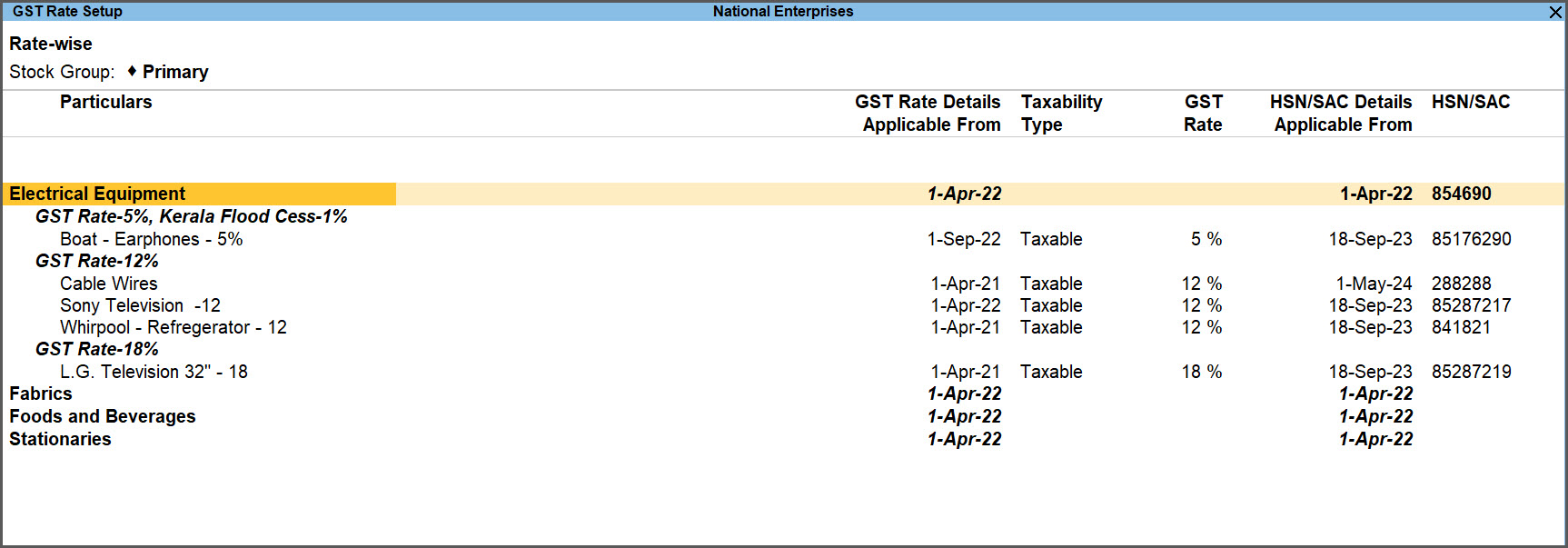

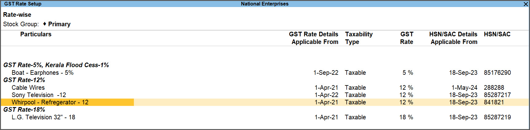

Once saved, the HSN appears against the Stock Items in GST Rate Setup as shown below:
gst-rate-setup-updated

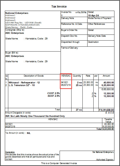

Now, the HSN will also appear in the printed copy of the invoice, as shown below:
tax-invoice-hsn

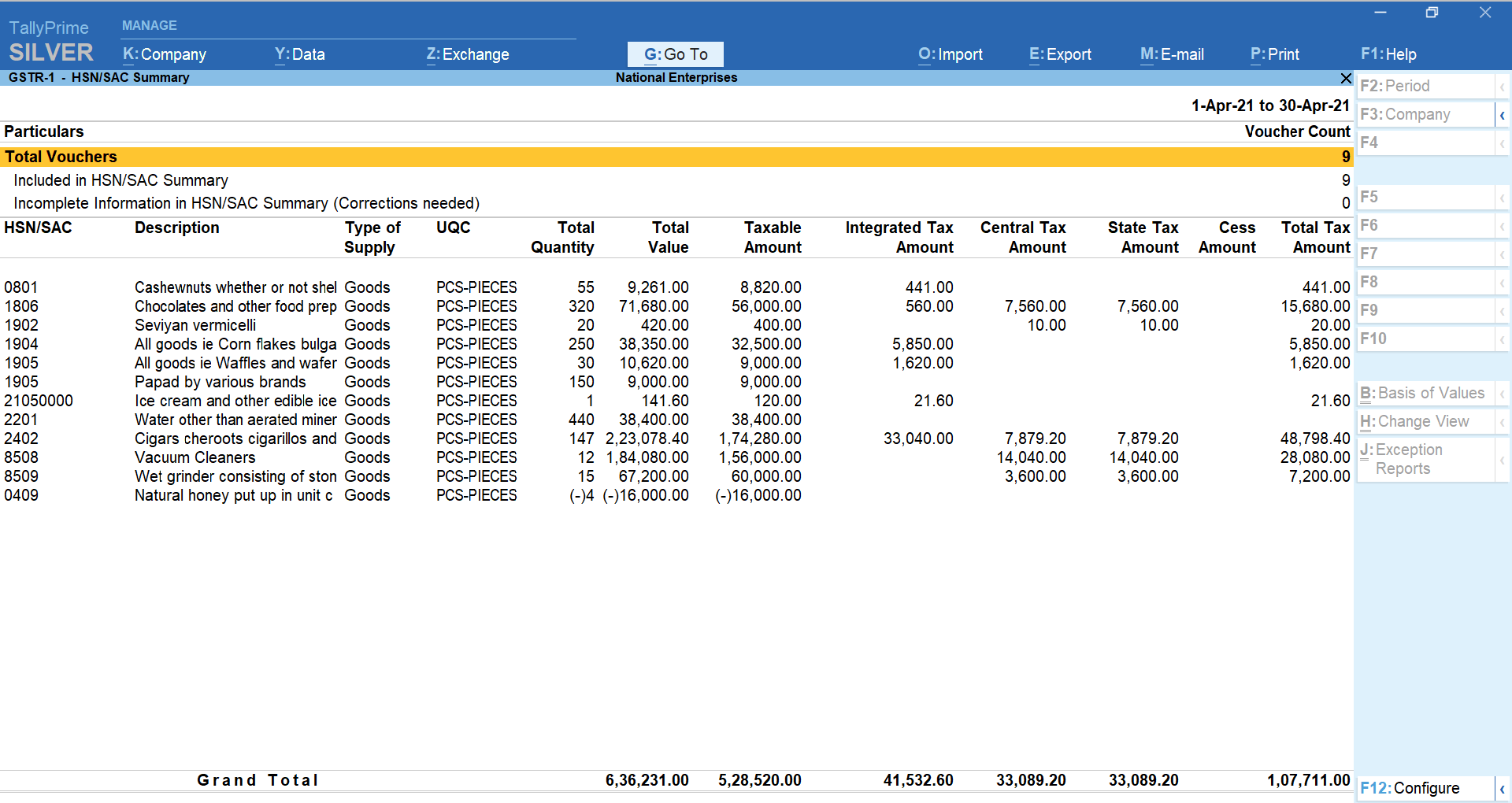

Once you set HSN Code in TallyPrime for Stock Items, the same will reflect in HSN/SAC Summary of the GSTR-1 report.
  1. Press Alt+G (Go To) > type or select GSTR-1 and press Enter.
    Alternatively, from Gateway of Tally > Display More Reports > GST Reports > GSTR-1 and press Enter.
    Note: If you do not find the Stock Items for which HSN Codes are updated in the HSN Summary, then ensure that you have selected the right Period.
    Press Alt+F2 to change the Period of the GSTR-1 report and then drill down on HSN Summary.
  2. Bring the cursor to HSN/SAC Summary and press Enter.
    The Stock Items for which the HSN Codes are set appear as shown below.
    HSN Summary in TallyPrime
If you have transactions involving those Stock Items for which you have updated HSN Codes and they do not appear here, then change the Period of the report.
