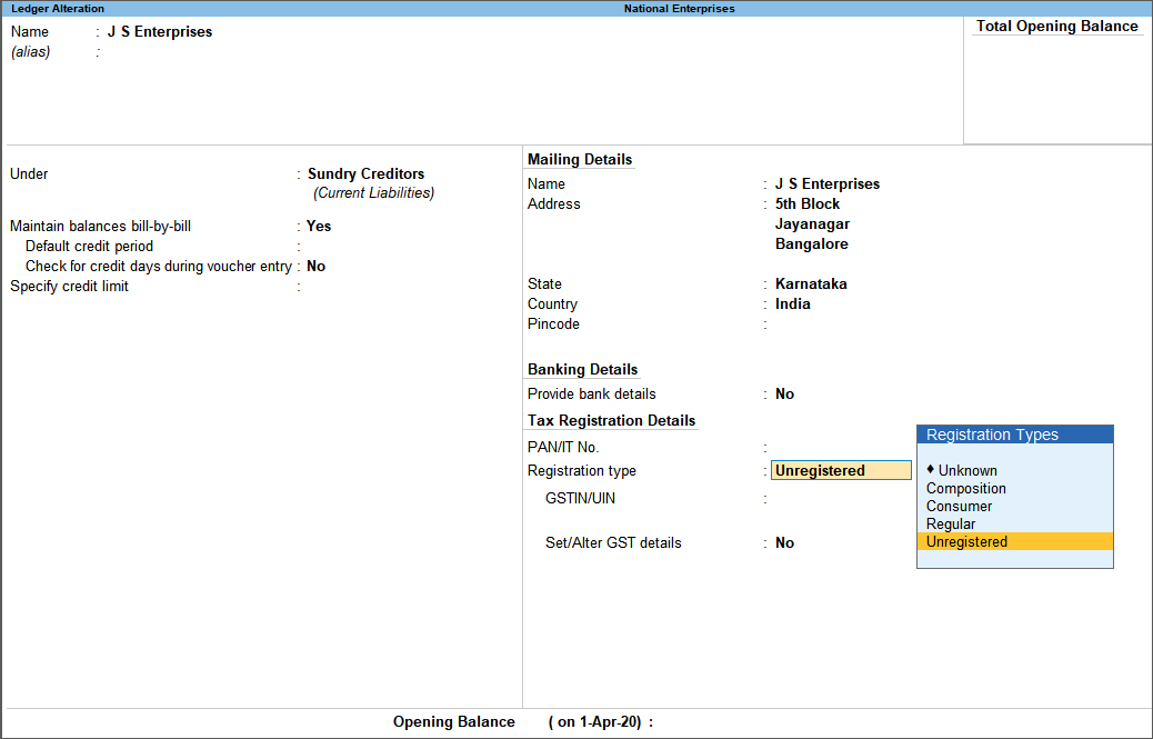

  1. Gateway of Tally > Alter > type or select Ledger > and press Enter.
    Alternatively, press Alt+G (Go To) > Alter Master > type or select Ledger > and press Enter.
  2. Select the required party ledger.
  3. Select the Registration type as Unregistered.
  4. Save the ledger.

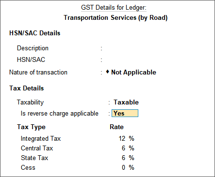

  4. Provide GST details.
    • Press F12 (Configure) > set the option Enable Reverse Charge calculation to Yes > and save the configuration screen.
    • In the GST Details screen, set the Taxability to Taxable.
    • Set Is reverse charge applicable to Yes.
    • Enter the GST rates.

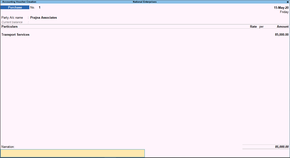

  2. Press Ctrl+H (Change Mode) to select the required voucher mode (Accounting Invoice, in this case).
  3. For Party A/c name, select the party ledger with Registration type set to Unregistered.
  4. Select the purchase ledger enabled for reverse charge.
  5. Press Ctrl+O (Related Reports) > type or select GST – Tax Analysis to view the tax details.
    If you are on TallyPrime Release 1.1.3 or earlier, follow the step:
    Press Ctrl+I (More Details) > type or select GST – Tax Analysis to view the tax details.
    Press Alt+F5 (Detailed) to view the tax liability under reverse charge.

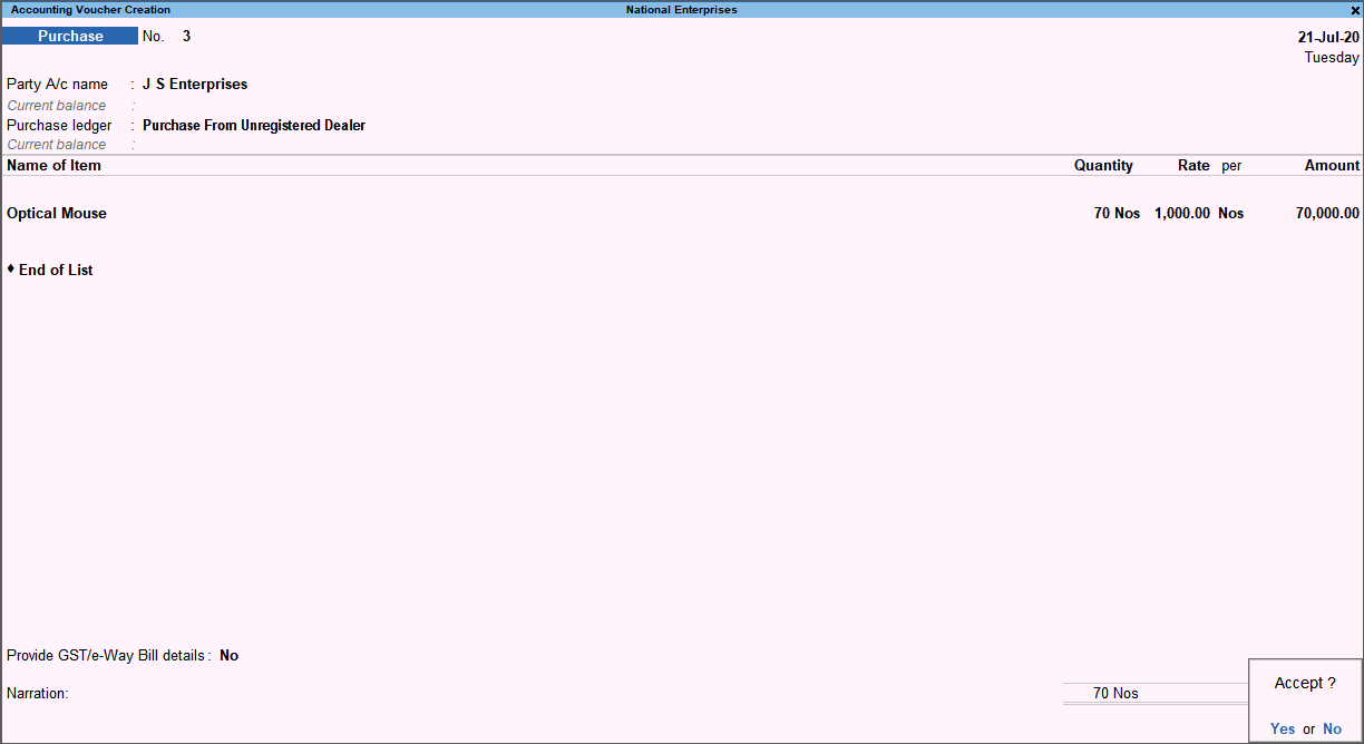

  6. Press Esc to return to the purchase invoice. The purchase invoice appears as shown:
  7. Press Ctrl+A to save.

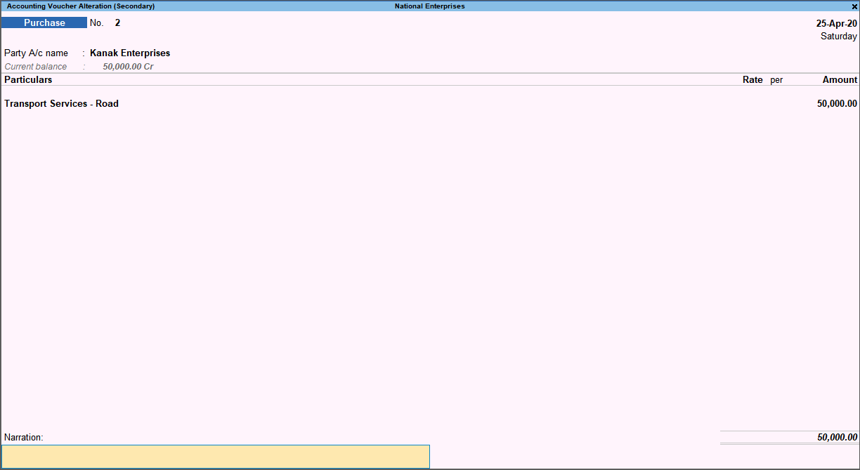

  1. Gateway of Tally > Vouchers > press F9 (Purchase).
    Alternatively, press Alt+G (Go To) > Create Voucher > press F9 (Purchase).

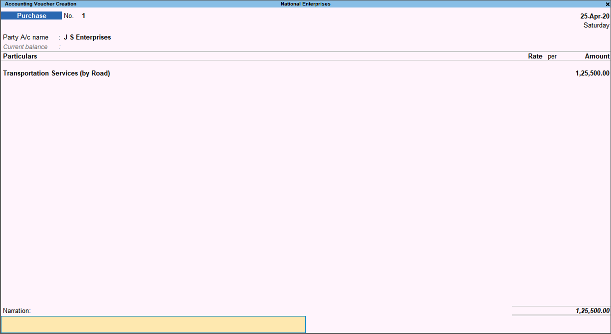

  3. For Party A/c name, select the interstate party ledger with Registration type set to Unregistered.
  4. Select the purchase ledger in which the options:
    • Nature of transaction is set to Interstate Purchase From Unregistered Dealer – Services.
    • Type of Supply is set to Services.

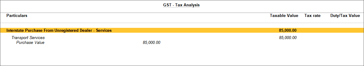

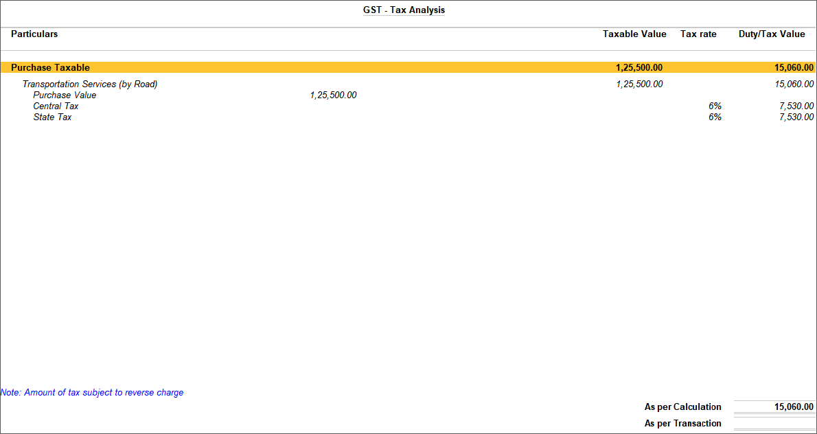

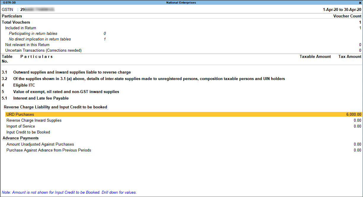

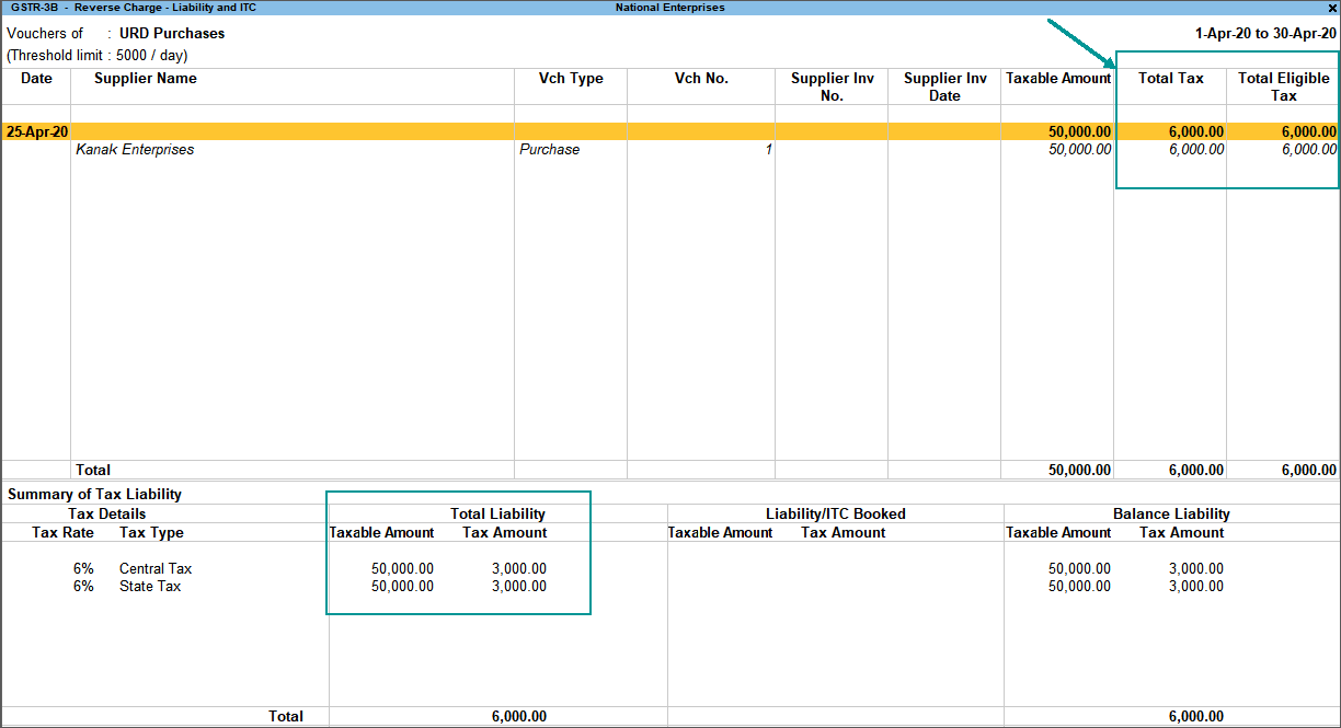

  3. Gateway of Tally > Display More Reports > GST Reports > GSTR-3B.
    Alternatively, press Alt+G (Go To) > type or select GSTR-3B > and press Enter.
  4. Press Enter on URD Purchases to view the liability on purchase from unregistered dealers.

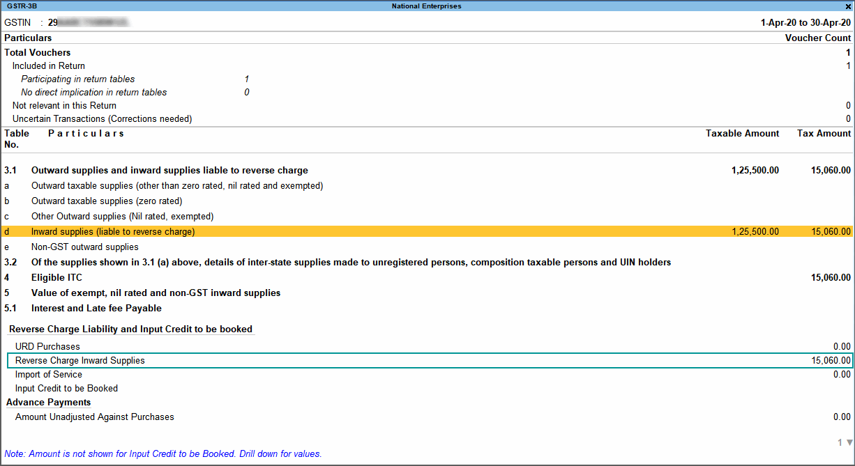

  5. Press F12 (Configure) and set Show eligible Input Tax Credit to Yes.

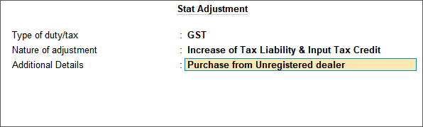

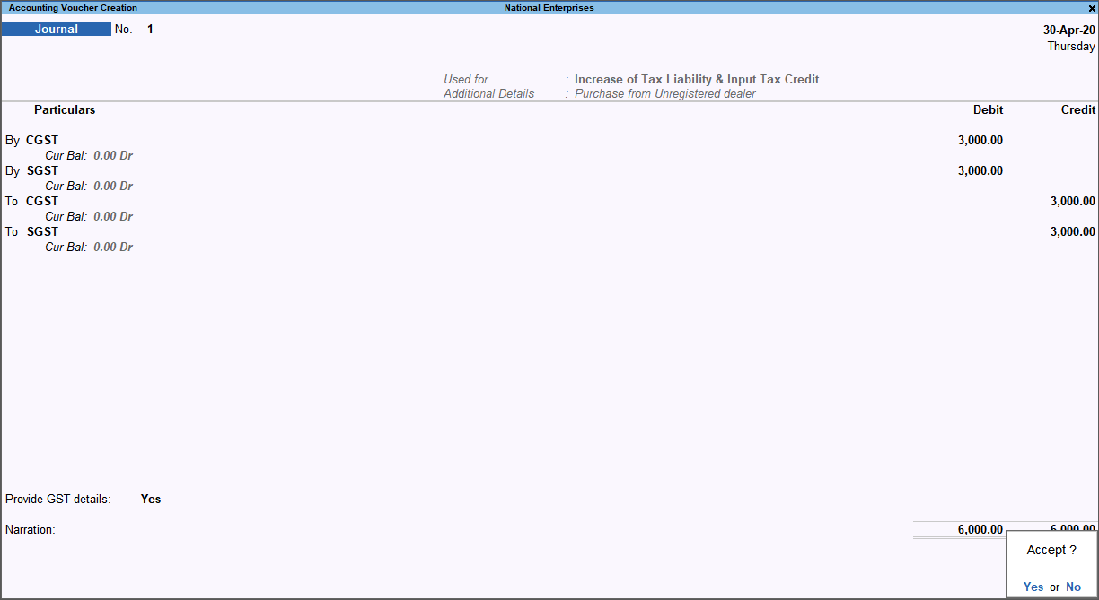

  6. Press Alt+J (Stat Adjustment) to record a journal voucher for increase in tax liability and tax credit, report this transaction to the department as a self-invoice. The value of this transaction appears in GSTR-3B report. For this, you need to debit and credit the same tax ledgers by entering the tax values.
  7. Select the options as shown below:
  8. Debit and credit the tax ledgers. Enter the GST Rate and Taxable Value for each tax ledger.
  9. Set the option Provide GST Details to Yes.
  10. Select the Type of Input.
  11. Press Enter to save.

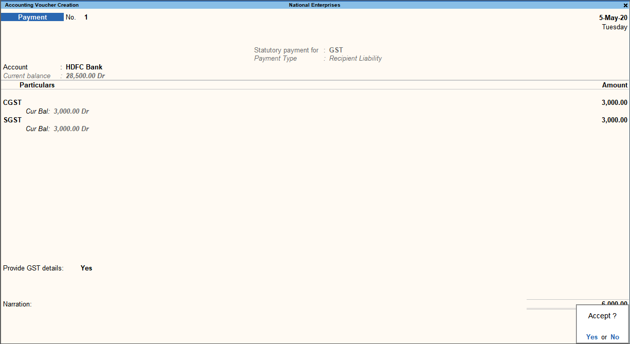

  1. Gateway of Tally > Vouchers > press F5 (Payment).
    Alternatively, press Alt+G (Go To) > Create Voucher > press F5 (Payment).

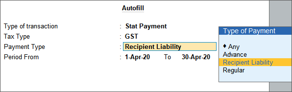

  2. Press Ctrl+F (Autofill) > select Stat Payment > select Payment Type as Recipient Liability.
  3. Select the bank from which the payment will be made.
  4. Select the central and state tax ledgers.
  5. Enable the option Provide GST details to enter the bank details.
    If the bank details are not available, you can enter them later in the Challan Reconciliation report.
  6. In the Bank Allocations screen, select the ledgers, enter the amount and provide the payment details.
  7. Press Enter to save.

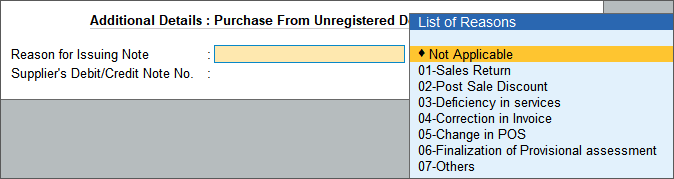

  2. In Party A/c name, select the party from whom the original purchase was made. Enter the Original Invoice No. and Date of the purchase transaction against which you are recording the current purchase return.
  3. Select the Nature of Return, and the Supplier’s Debit/Credit Note No. and Date in the Statutory Details screen.

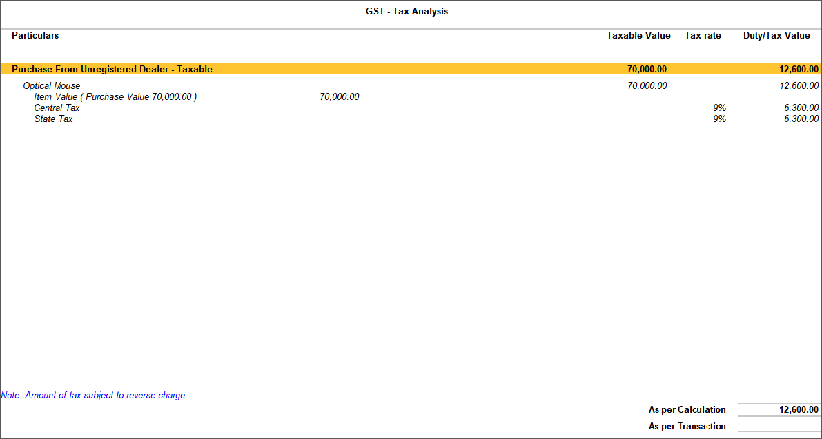

  4. The tax liability gets calculated and displayed in the GST – Tax Analysis screen (press Ctrl+O (Related Reports) > type or select GST – Tax Analysis) as shown below:
