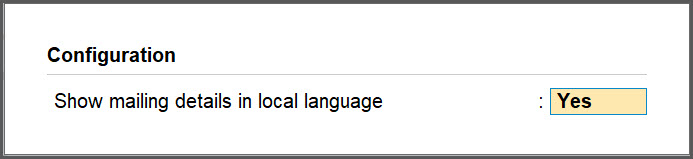

  1. Open TallyPrime and press F11 (Company Features).
  2. Set Enable Value Added Tax (VAT) to Yes and press Enter.
  3. In the VAT Details screen, press F12 (Configure).
  4. In the Configuration screen, set Show mailing details in local language to Yes.
    show-mailing-details-in-local-language
  5. Set Mailing details in local language to Yes.

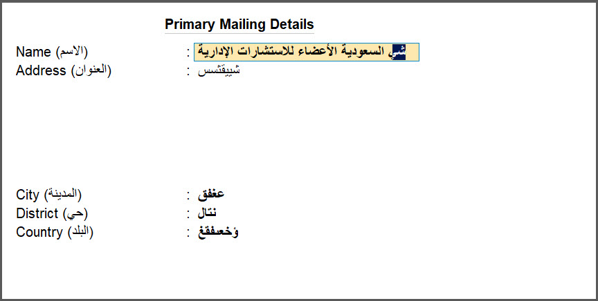

  6. In the Primary Mailing Details screen, enter the name of the company and mailing details in Arabic.
    primary-mailing-details-arabic

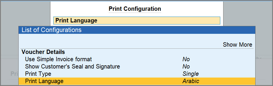

If you want to print your invoice in Arabic only, you can select Print Type as Single and Print Language as Arabic in Print Configuration.
print-language-arabic

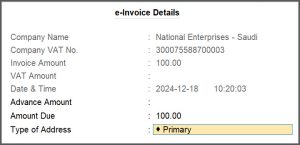

While passing the sales voucher,
  1. Enter relevant details, such as Party A/c Name, Sales Ledger, Name of Item, and VAT Ledger.

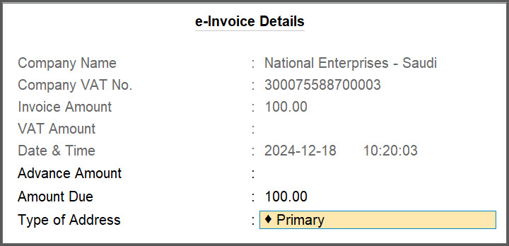

  2. Set Show e-Invoice details to Yes and press Enter.

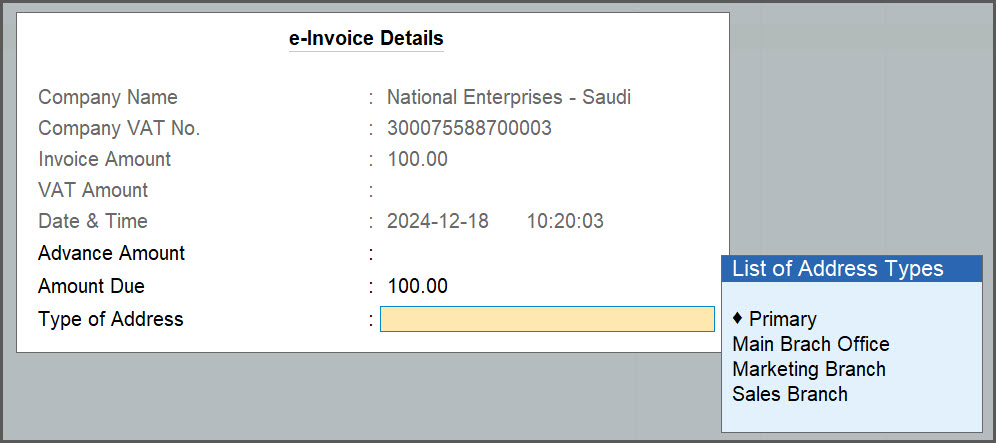

  3. In the e-Invoice Details screen, select the relevant address from the Type of Address field.
    e-invoice-details
  4. Ensure that each address given in the List of Address Types should have a specific seller ID (for example, Commercial Registration No. (CRN), MOMRAH License No., and so on). The selected address with the given seller ID details will be exchanged on the ZATCA portal.
    e-invoice-dropdown

To configure company mailing details in Arabic,
  1. Open the company in TallyPrime.
  2. Press F11 (Company Features) > Enable VAT > F12 (Configure) > Set Show mailing details in local language to YES.

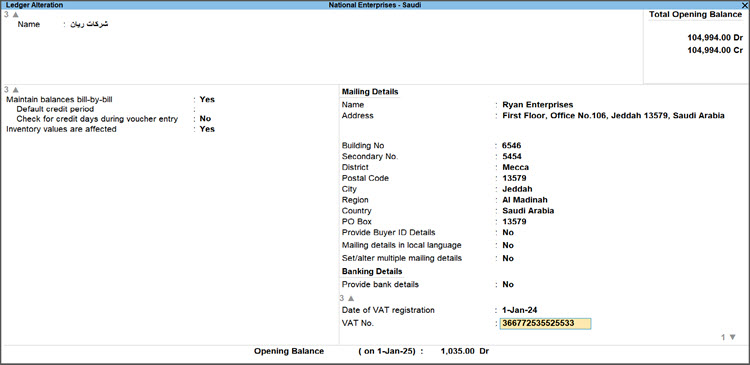

To avoid errors and warnings from ZATCA, ensure that the below-mentioned fields are filled in the Mailing details of the party ledgers:
  • Name (both in English and Arabic)
  • Address (both in English and Arabic)
  • Building number
  • City (both in English and Arabic)
  • District (both in English and Arabic)
  • Postal Code
  • Country (both in English and Arabic)
  • Additional Buyer ID

During voucher creation, enable Show e-Invoices details.
You can then mention the due amount receivable.

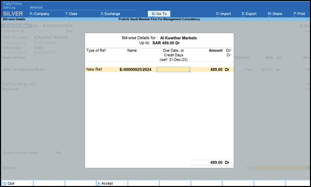

billwise-details
No, providing Bill-wise Details in Advance Receipt is not mandatory as per the regulations by ZATCA.
However, we recommend you to enable the Maintain Balance Bill-by-Bill option under F11 and party ledger.
In an Advance Receipt, you need to select Advance as a type of reference and provide details.
This enables you to show the tax liability in the Advance Receipt Details screen and set off the advance receipt e-Invoice with the Sales e-Invoice.

Yes, it is mandatory to provide ledger mailing details in Arabic to generate the e-invoice.

Cause: The VAT No. mentioned for the particular party is incorrect.
vrn-three-digits
Resolution:
Check the VAT No. in the VAT Details screen for the particular party.
  1. Open the particular party ledger in alteration mode.
  2. Update the VAT No. to make sure that it is of 15 digits, starting and ending with the digit ‘3’.
    ledger-alteration-saudi-arabic
  3. Press Ctrl+A to save.

The purpose of Show mailing details in local language available under Enable VAT menu in Company Features is to update the company details in local language. If you will not provide the company details in local language, you might receive warnings from ZATCA after e-Invoice generation.
