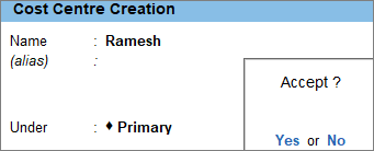

Create Cost Centres
The main function of Cost Centres (also known as Profit Centre) is to keep track of the expenses incurred. Suppose, you have multiple departments and you want to know the expenses incurred or revenue generated by the employees under the departments. You can track such expenses and incomes by creating Cost Centres of the employees.

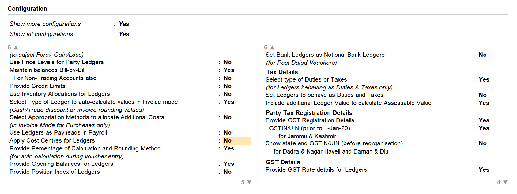

  1. Press Alt+G (Go To) > Create Master > Cost Centre > press Enter.
    Alternatively, Gateway of Tally > Create > Cost Centre > press Enter.
    If the feature is inactive, you will be prompted to activate the Cost Centres feature. Select Yes or press Y to proceed.

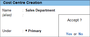

  2. Name & alias: Provide a name. As in other masters, you can specify multiple aliases.
  3. Under: Select Primary or an existing Cost Centre.
    Single Cost centre creation
  4. Accept the Cost Centre Creation screen. As always, you can press Ctrl+A to save.

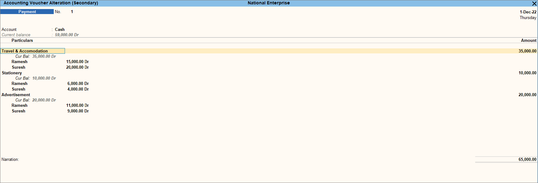

Allocation of expenses to Cost Centres
Consider the example of employees – Ramesh and Suresh – travelling across the country to conduct events, such as training and demo sessions at the client location. The expenses incurred by Ramesh and Suresh are:
Expense Head
Ramesh
Suresh
Travel and Accommodation 15,000 20,000
Stationery   6,000   4,000
Advertisement Expense 11,000   9,000
These expenses can be recorded by allocating the amounts to the respective Cost Centres – Ramesh and Suresh.

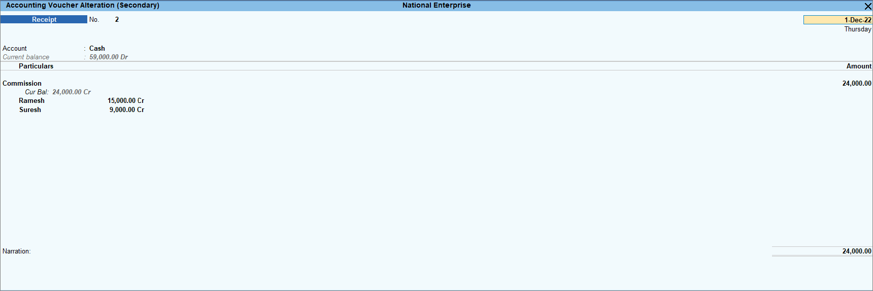

At the same time, the company also received a commission as income.
Income Head
Ramesh
Suresh
Commission 15,000 9,000

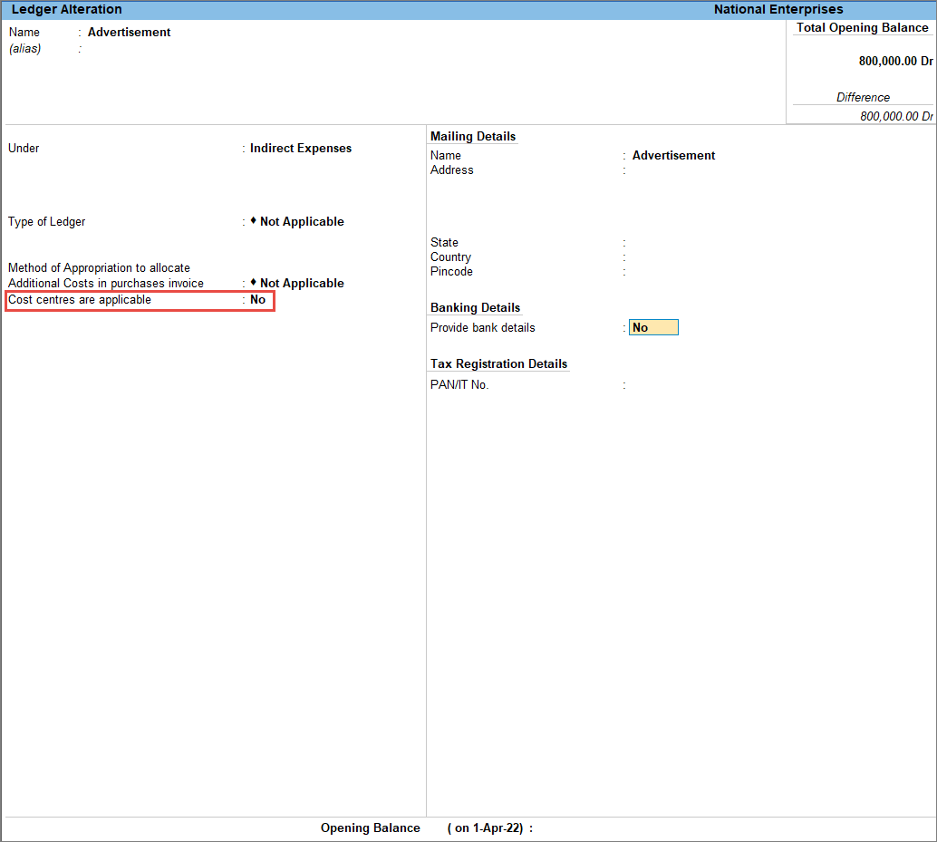

By default, this option is set to Yes in the income and expense ledgers, whereas it is set to No in the asset and liability ledgers.
  1. In the Payment Voucher, in Single Entry mode, select Cash or Bank in the Account field.
  2. Enter the expense ledger Travel and Accommodation and the corresponding amount and press Enter.

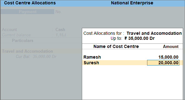

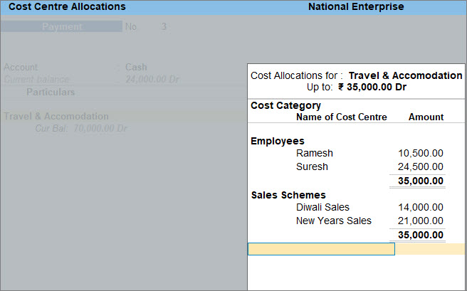

    The Cost Centre Allocations screen appears.
  3. Provide the Cost Centre details.
    1. Enter the employee name under Name of Cost Centre.
    2. Enter the allocated amount for that employee under Amount.
      You need to allocate the total expenses against one or more Cost Centres.
    3. Press Ctrl+A to save the Cost Centre Allocations screen.
      Cost-Centre-Allocation
  4. Enter the expense ledgers Stationery and Advertisement with their amount and Cost Centres.
    The payment voucher with expenses allocated to Cost Centre, as shown below:
    Cost-centre-allocation-in-transaction
  5. Accept the screen. As always, press Ctrl+A to save the Payment Voucher.
The receipt voucher for Commission with Profit Centre allocation appears, as shown below:
Profit-centre-allocation-in-transaction

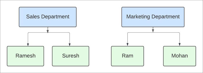

Consolidate Allocations to Cost Centres for Unit-wise Expenses
You can create multiple Cost Centres (also known as Profit Centres) in a hierarchy to get a consolidated view of the allocations made to each business unit, employee, project, department, and so on.
To get a hierarchy of Cost Centres you just need to group the required cost centre under the cost centre created for the group. For example, you can create Cost Centre like Sales Department or Marketing Department and further create cost centres as employee names under each department to form the hierarchy.

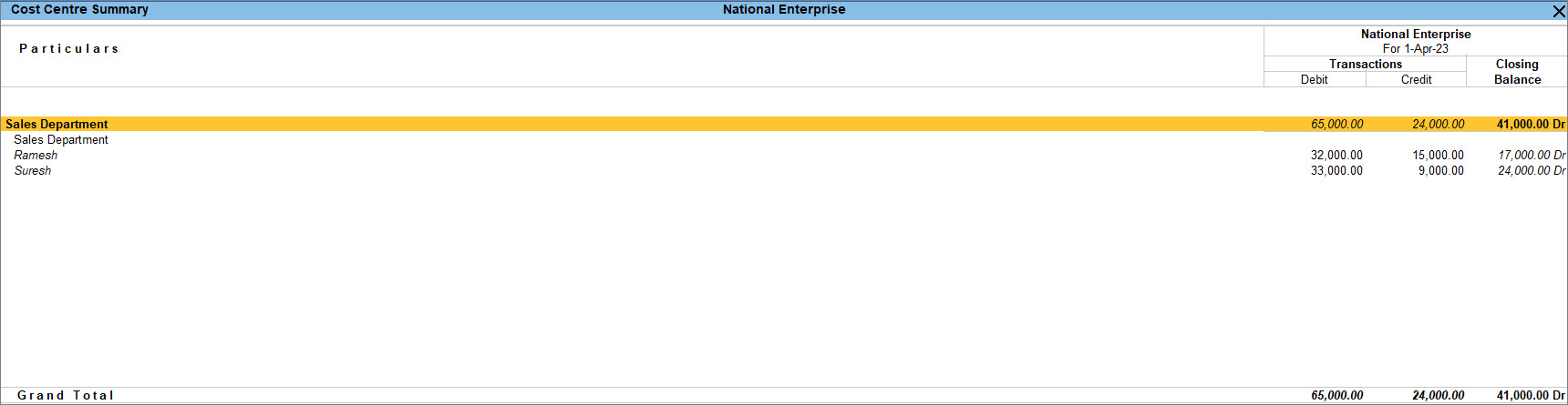

  1. Create a Cost Centre named as Sales Department.
    Creation-of-cost-centre

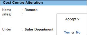

  2. Move the cost centres Ramesh and Suresh under the cost centre Sales Department.
    1. Press Alt+G (Go To) > Alter Master > Cost Centre > Ramesh > press Enter.
      Alternatively, Gateway of Tally > Alter > Cost Centre > Ramesh > press Enter.
    2. Select Sales Department in the Under field.
    3. Alter the Cost Centre Suresh and keep it under Sales Department.
      Similarly, create other Cost Centres.

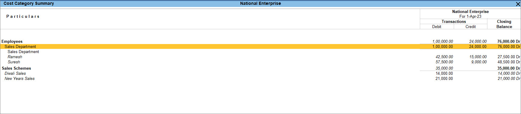

  3. Go to the Cost Centre Summary report to view the consolidated expenses and incomes of the Cost Centres created under the Sales Department.
    Cost-Centre-Summary
Once the hierarchy is created whenever you allocate an expense to any of the employees, it would also become part of the relevant department.

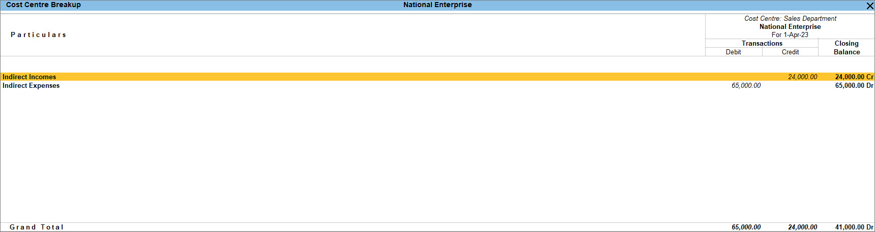

Track Income and Expenses Incurred Cost Centre-Wise
The Cost Centre Breakup report gives you the income and expense allocated to the selected Cost Centre or Profit Centre. As in any other report, you can explore and drill down to view the details for a particular Cost Centre. At the last level of drill-down, you can alter the contributing transactions, if needed.

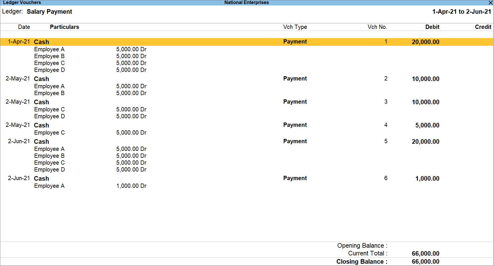

Cost Centre Breakup in Ledger Reports
  1. Press Alt+G (Go To) > Ledger Vouchers > type or select ledger name and press Enter.
  2. Press F2 (Period) > enter From and To
    The Ledger Voucher report for the selected report will be displayed.

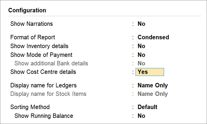

  3. Press F12 (Configure) and set the following:
    • Format of Report : Detailed.
    • Show Cost Centre details: Yes
      Cost Centre Details Set as No Under Configurations of Ledger Voucher Reports in TallyPrime
      The Ledger Vouchers report appears as shown below:
      Ledger Voucher Reports with Cost Centre in TallyPrime

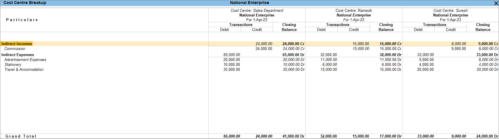

Cost Centre Breakup
The Cost Centre Breakup report gives you the ledger-group-wise view of incomes and expenses incurred and allocated to the selected Profit Centre or Cost Centre.
  • Press Alt+G (Go To) > type or select Breakup of Cost Centre.
    Alternatively, Gateway of Tally > Display More Reports > Statements of Accounts > Cost Centres > Cost Centre Break-up.
    Breakup-of-cost-centre

Cost Centre Summary
This report displays the summary of incomes and expenses allocated to different Profit Centres or Cost Centres.
  • Press Alt+G (Go To) > type or select Cost Centre Summary.
    Alternatively, Gateway of Tally > Display More Reports > Statements of Accounts > Cost Centres > Cost Centre Summary.
    The detailed view (press Alt+F5) of the report appears as shown:
    Cost-Centre-Summary
You can also compare the Cost Centre Monthly Summary by pressing Alt+N (Auto Column).

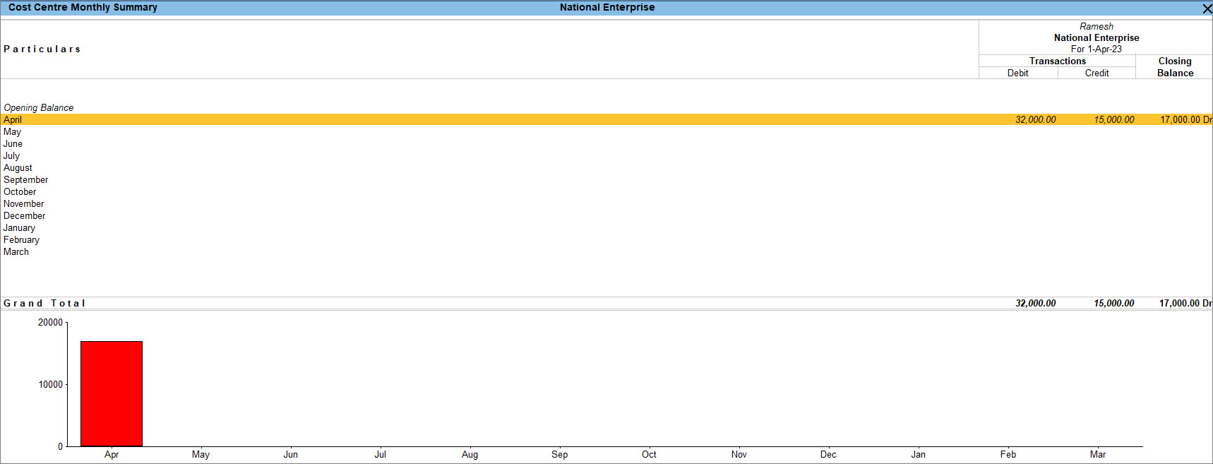

You can view the monthly breakup of income and expense details along with the closing balance for the selected Cost Centre.
  1. Press Alt+G (Go To) > type Cost Centre Monthly Summary.
    Alternatively, you can drill down from the Cost Centre Summary report.
    Cost-Centre-Monthly-Summary

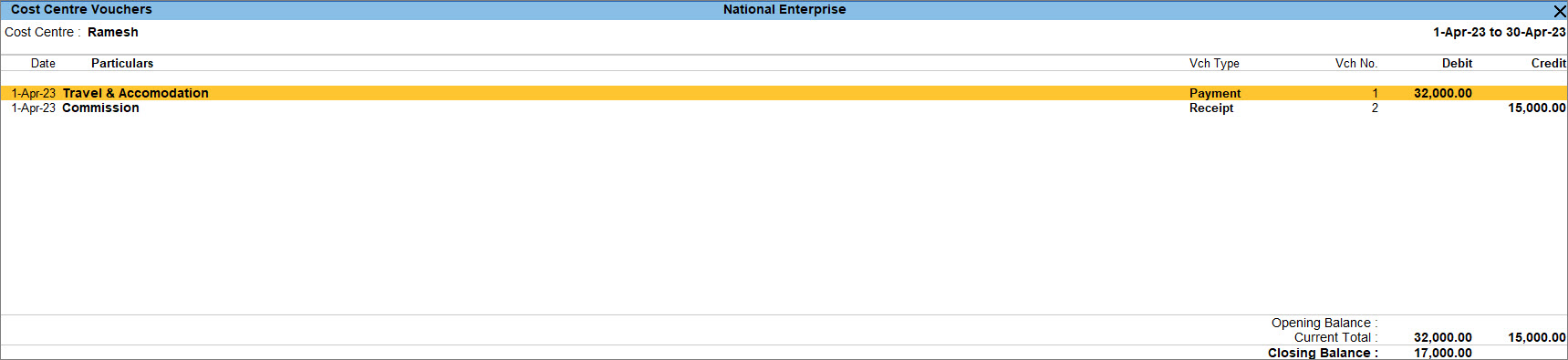

  2. Select the required month and press Enter, to view the Cost Centre Vouchers report.
    Cost-centre-vouchers

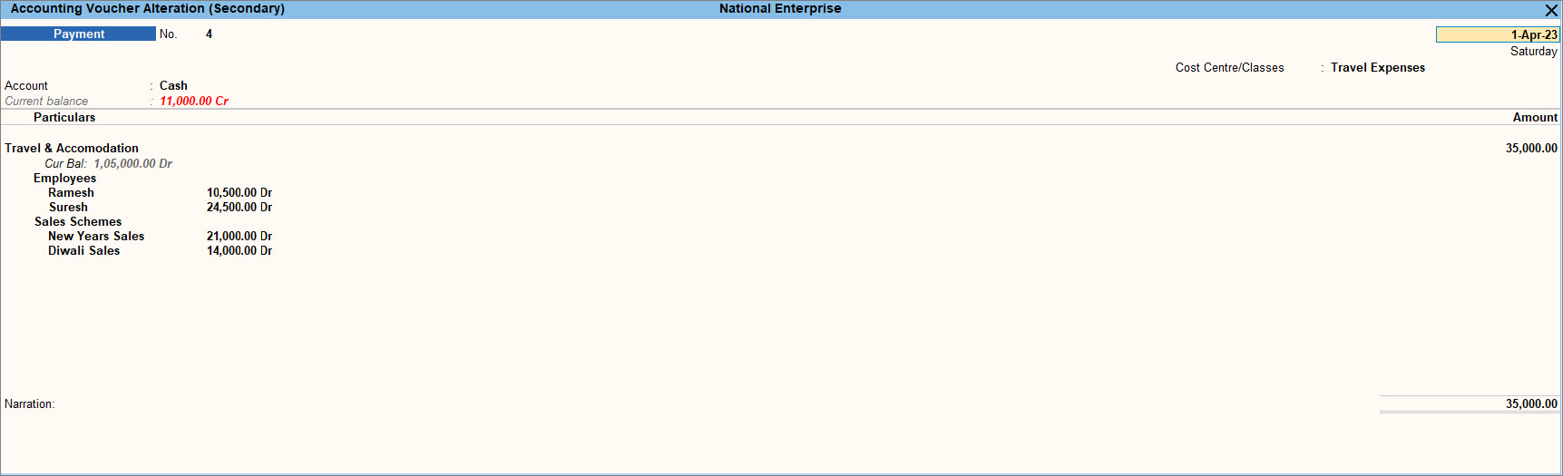

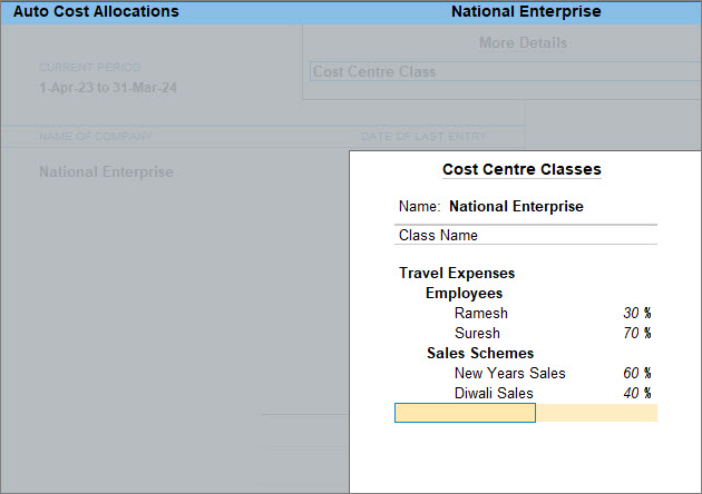

Use Cost Category for Parallel Allocation
To allocate the same income and expense to multiple Cost Centres or Profit Centres, you can create a Cost Category for parallel allocation. You can create a Cost Category and classify Cost Centres to get a better analysis of your cost and revenue.
Consider an organisation running multiple Sales Schemes to boost sales. For example, Diwali Sales, New Year Sales, and so on.
From the below table, we can see the representation of how the same expenses incurred under Travel and Accommodation and Stationery can be allocated to Employees – Ramesh & Suresh and to the Sales Schemes – Diwali Sales and New Year Sales with parallel allocation.
  Cost Category Employees Sales Schemes
  Cost Centre Ramesh Suresh Diwali Sales New Year Sales
Expenses (ledgers)
Total Amount
Travel and Accommodation 35,000 10,500 24,500 14,000 21,000
Stationery 10,000   6,000   4,000   3,000   7,000
By default, TallyPrime considers all Cost Centres under an internal category called Primary Cost Category. You can rename the Primary Cost Category at any time. As in the case of other masters, if you alter anything in Cost Category Masters, the changes will reflect in corresponding transactions and reports.
You can create any number of Cost Categories as needed. You can maintain Cost Centres under Primary Cost Category or under the Cost Categories that you create.
You can create Cost Category for both revenue and non-revenue items and then allocate the expenses to the respective cost centres. Revenue Items refer to all your expenses and incomes. Non-revenue items refer to Assets and Liabilities.

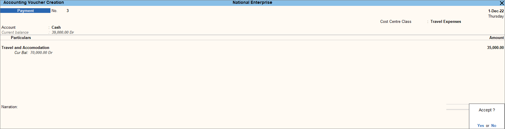

When you record transactions after creating a new Cost Category, in the Cost Centre Alteration screen you need to select the required Cost Category.

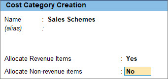

      1. Name & alias: As in other masters, you can specify multiple aliases.
      2. Allocate Revenue Items & Allocate Non-revenue items – You can enable both options if the Cost Category is created for both items. However, it is mandatory to enable either one of the options to create the Cost Category.
        Cost-category-creation
      3. Accept the Cost Category screen. As always, you can use Ctrl+A to save.

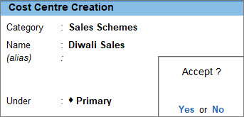

Attaching Cost Centres to Cost Category
Once you have created a Cost Category, you can alter the Cost Centres and attach those Cost Centres to the newly created Cost Category.
By default, the cost centres are tagged to Primary Cost Category. If you rename the Primary Cost Category, the existing Cost Centres show the new name.
  • In the Cost Centre Creation/Alteration screen, in Category, select the Cost Category of your choice.
    Press Backspace on the Name field to move to the Category field.
    Cost-Centre-attached-to-Cost-Category

Cost Category for Parallel Allocation of Expenses and Incomes to Cost Centres or Profit Centres in Transactions
When you create more than one Cost Category and have Cost Centres (also known as Profit Centres) under it, the Cost Categories along with their respective Cost Centres appear for selection during the parallel allocation of incomes and expenses.
For example, below are the expense allocation details for Cost Category Employees and Sales Schemes.
  1. In the Payment Voucher, record the payment entry for Travel and Accommodation.
  2. Enter the corresponding Amount and press Enter.
  3. Provide the details in the Cost Centre Allocations screen.
    1. Select the Cost Category, say Employees.
    2. Select the Name of Cost Centre, say Ramesh and Suresh
    3. Enter the amount for each Cost Centre.
      A sample Cost Centre Allocations screen appears, as shown below:
    4. Do the same for Cost Category – Sales Schemes and Cost Centres – Diwali Sales and New Years Sales.
      Parallel-allocation
    5. Accept the Cost Centre Allocations screen.
  4. As always, press Ctrl+A to save the Payment Voucher.

Cost Category Summary
This report displays the summary of incomes and expenses allocated to a parallel set of Profit Centres or Cost Centres in your business.
  • Press Alt+G (Go To) > type or select Cost Category Summary.
    Alternatively, Gateway of Tally > Display More Reports > Statements of Account > Cost Centres > Category Summary.
    cost-category-summary
You can compare different Cost Categories to see the variance by pressing Alt+N (Auto Column) and change the Scale Factor by pressing Ctrl+B (Basis of Value).
To know more, refer to the Working with Reports topic.

To predefine the Cost Centres and Cost Category along with the percentage allocation for an easy recording of transactions you need to create a Cost Centre Class.
  1. Press F11 (Features) > Ctrl+I (More Details) > type or select Cost Centre Class.
    If the feature is inactive, you will be prompted to enable the Cost Centres Class feature. Select Yes or press Y to proceed.
  2. Type the Class Name, and select the Category and the respective Cost Centres created for your business. Specify the percentage of allocation.
    Cost-centre-Class
In the above example, the Cost Centres (Diwali Sales & New Years Sale and Ramesh & Suresh and Cost Categories Employees & Sales Schemes) are allocated at predefined percentages for:
  • Cost Centre Class – Travel Expenses.
  • Cost Category – Employees (with cost centres Ramesh and Suresh) and Sales Schemes (with Diwali Sales and New Year Sales).

With the creation of the Cost Centre Class, the allocation of expenses and incomes to the Cost or Profit Centres is done automatically as soon as the Cost Centre Class is selected in the respective Vouchers. For example, let us use the Cost Centre class, Travel Expenses in the Payment Voucher.
  1. Enable Cost Centre Class in Payment Voucher.
    1. In the Payment Voucher, press F12 (Configure).
    2. Set Select Cost Centre/Class to Yes.
    3. Accept the Configuration screen.
  2. Record the Payment Voucher entry.
    1. Select Cash or Bank in the Account field.
    2. Select the Cost Centre Class, for example, Travel Expenses.
      Payment-voucher-with-class
    3. Select the expense ledger under Particulars and Amount.
      You do not have to allocate the expenses to the Cost Centres. It gets allocated as defined in the Cost Centre Class.
    4. Accept the voucher. As always, press Ctrl+A to save the Payment Voucher.
  3. Check the allocation of expenses as per the class.
    1. Open the Voucher in alteration mode to view the Cost Centre allocation or press Page Up.
      The cost centre allocation will be displayed.
      Payment-voucher-with-class-in-As-voucher

Disable cost centre for a specific ledger
It may be possible that you have enabled Cost Centres for the Advertisement ledger. However, later on, you realise that you do not need Cost Centres for the advertising cost. In such a case, you may want to disable the Cost Centre for the advertising cost.
To disable the Cost Centre for a specific ledger, follow the steps given below.
  • In the Ledger Alteration screen, set Cost centres are applicable as No.
    Disable-cost-centre-for-specific-ledger
  • As always, press Ctrl+A to save the Ledger Alteration screen.
Henceforth, Cost Centres will not be applicable to this ledger, and you will not have to select a Cost Centre for this ledger while recording transactions.
Disable cost centre for all ledgers
You may want to disable Cost Centres for all the ledgers, as you do not need to assign Cost Centres to the ledgers anymore. In such a case, you can disable Cost Centres for all the ledgers in TallyPrime. If the Cost Centres are already used in any transaction then before you disable the Cost Centre you need to move the allocation to another Cost Centre and then you can disable it.
Follow the steps given below.
  • In the Ledger Alteration screen, press F12 (Configure) and set Apply Cost Centres for Ledgers as No.
    set-apply-cost-centres-for-ledgers-to-yes-ledger-configuration-tallyprime
Once the Cost Centres are disabled, you will not be able to see the Cost Centre Breakup report.
