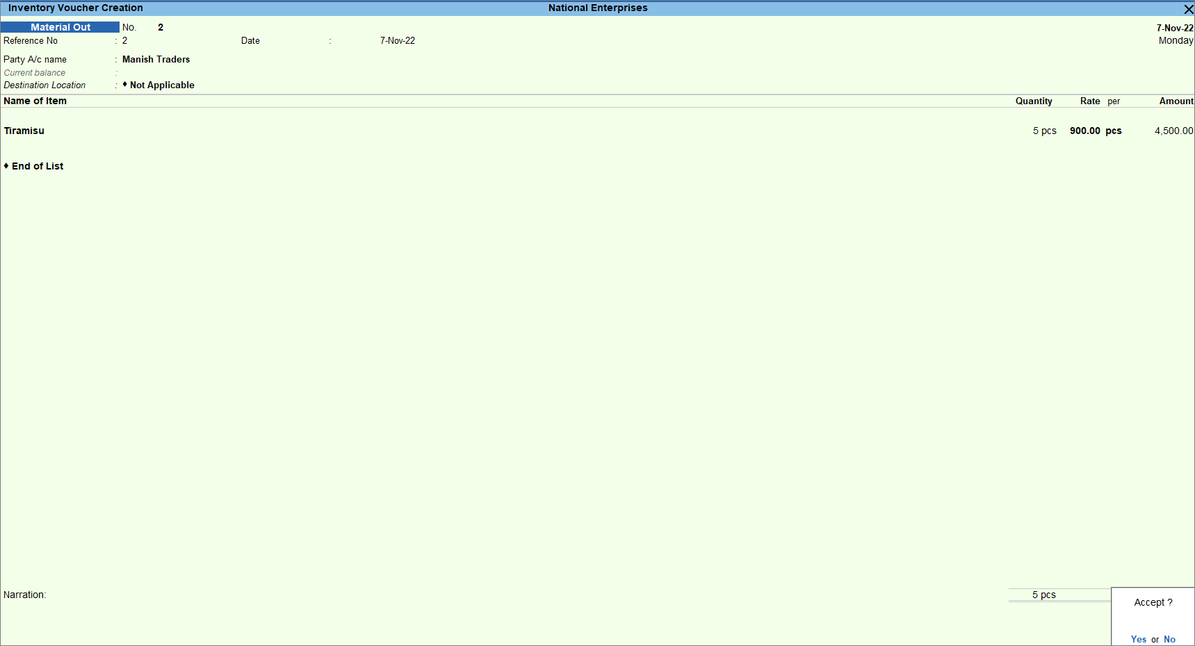

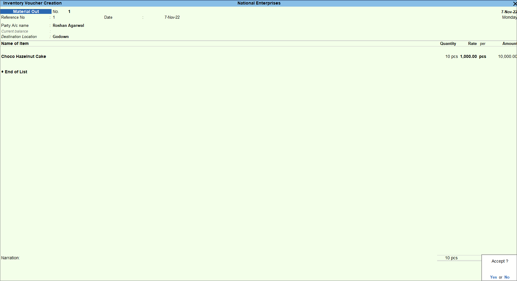

  2. Open the Material Out voucher and select the godown.
    1. Press Alt+G (Go To) > Create Voucher > F10 (Other Vouchers) > type or select Material Out.
      Alternatively, Gateway of Tally > Vouchers > F10 (Other Vouchers) > type or select Material Out.
      You can activate the Material Out voucher type if the voucher is inactive. Select Yes or press Y to proceed.
    2. Select the customer’s (consignment agent’s) name as the Party A/c Name.
    3. For Destination Godown, select the godown in which the option Our Stock with Third Party is set to Yes.

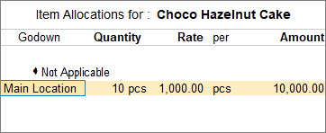

  3. Provide the stock item details.
    1. Select the stock item.
    2. Select the Godown in which the options Our Stock with Third Party and Third party Stock with us are set as No.
    3. Enter the Quantity and Rate. The amount appears automatically.
      Stock-transfer-to-agent.
    4. Press Ctrl+A to accept the screen.

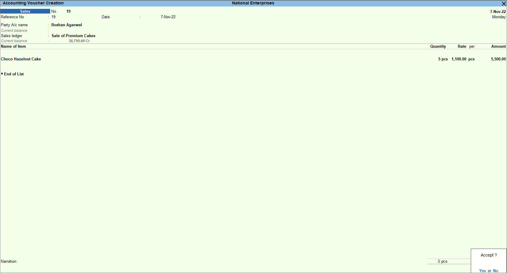

Record sales of goods by third party
When you send the goods to a third party for consignment sale, as and when you receive information from the consignment agent about the goods sold, you need to record such sales in the sales invoice. TallyPrime allows you to record such sales.
  1. Open the sales voucher screen.
    1. Press Alt+G (Go To) > Create Voucher > press F8 (Sales).
      Alternatively, Gateway of Tally > Vouchers > press F8 (Sales).
    2. Press Ctrl+H (Change Mode) > select Item Invoice.
  2. Specify the buyer details.
    1. Party A/c Name: Select the ledger created for the consignment agent.
      The Dispatch Details screen appears.
    2. Dispatch Details: Enter the Dispatch Details, as needed and press Enter.
      You can choose to enable the option for Order Details by pressing F12 (Configure).
      The Party Details screen appears.
    3. Party Details: You can update the agent details while recording the transaction and print the same in the invoice.
    4. As always, press Ctrl+A to save and proceed.
  3. In the Sales ledger, select the common sales ledger.

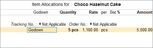

  4. Provide the stock item details.
    1. Select the stock item and press Enter to view the Stock Item Allocations screen.
    2. Select the godown where the option Our Stock with Third Party is set as Yes.
      sale-by-agent
      Record sale of goods by third party
  5. Provide Narration, if needed. As always, press Ctrl+A to save.
Once the sales voucher is recorded you can track the stock with your agent.

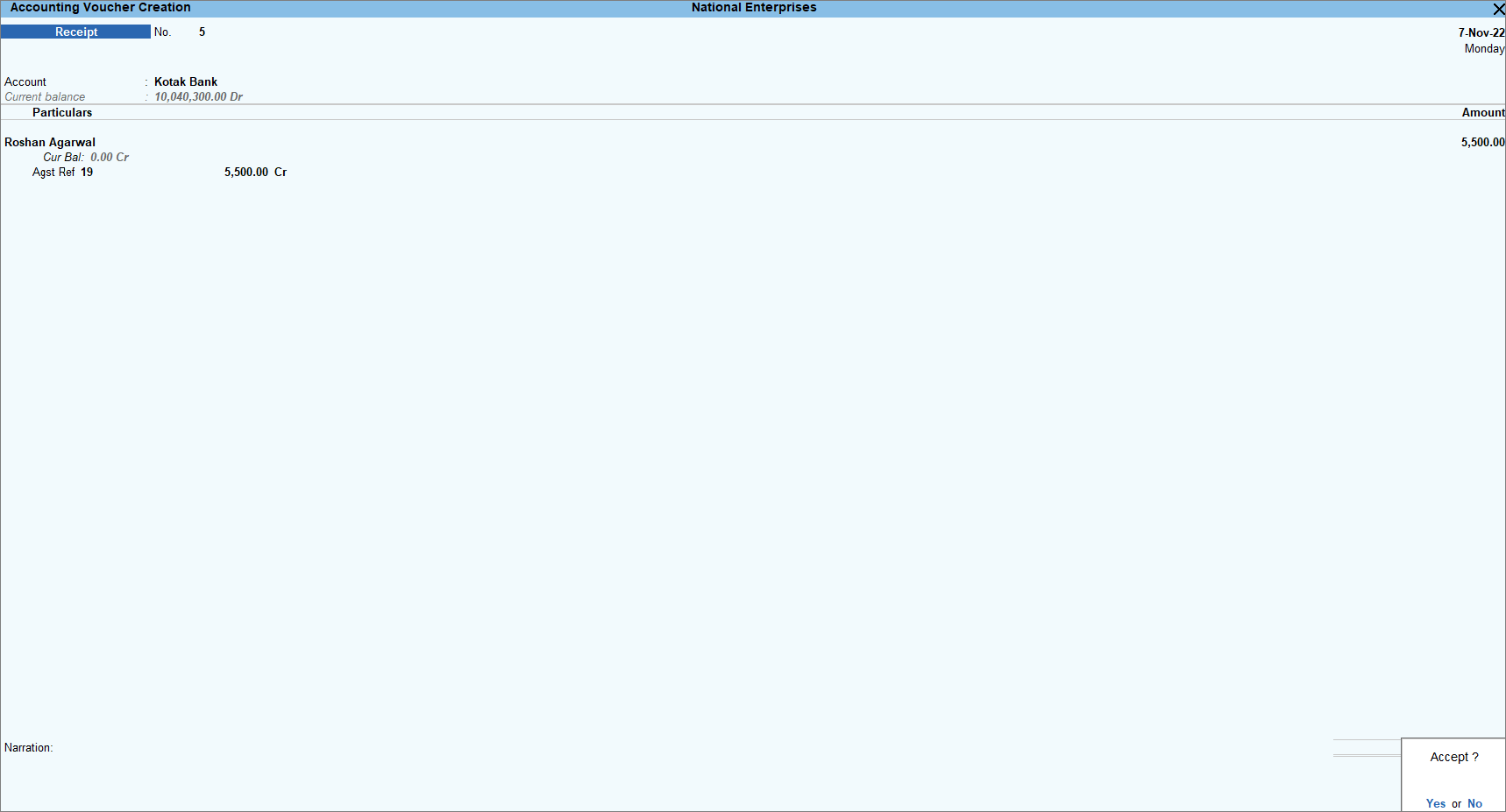

Record receipt of sale value from third party
When the goods are sold by the consignment agent, either in cash or credit, as and when he receives the money and informs the same, you need to record such transaction through a receipt voucher. In TallyPrime, the amount received from the consignment agent is recorded as usual.
  1. Open a receipt voucher and enter the amount received.
    1. Press Alt+G (Go To) > Create Voucher > press F6 (Receipt).
    2. Account: Select cash or bank ledger.
    3. Particulars: Select the consignment agent’s ledger.
    4. Amount: Enter the amount received.

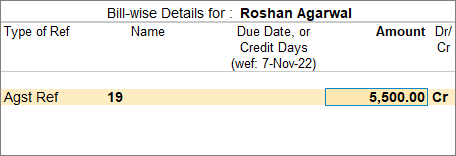

  2. Select the sales bill against which you have received the amount.
    1. Select Against Ref as the Method of Adjustment.
    2. Select the sales invoice reference details.
  3. Enter the bank details if the amount is received the amount via bank transfers.
  4. As always, press Ctrl+A to save.

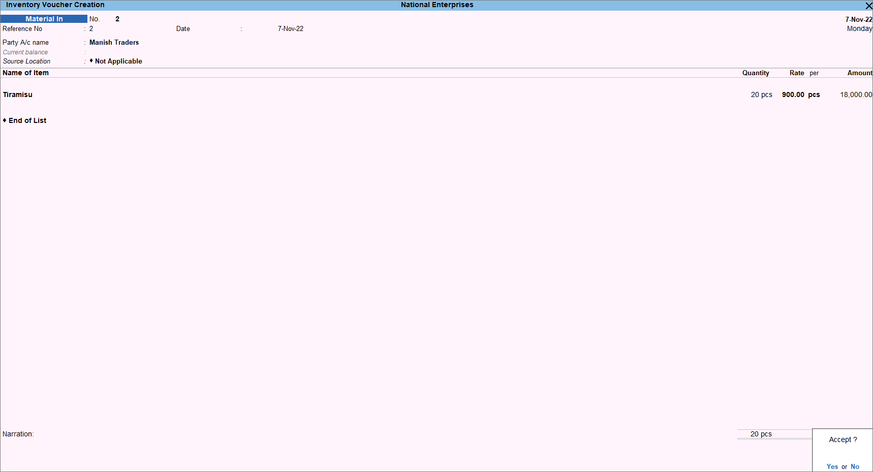

  2. Open the Material In voucher and select the godown.
    1. Press Alt+G (Go To) > Create Voucher > F10 (Other Vouchers) > type or select Material In.
      Alternatively, Gateway of Tally > Vouchers > F10 (Other Vouchers) > type or select Material In.
      You can activate the Material In voucher type if the voucher is inactive. Select Yes or press Y to proceed.
    2. Select the supplier’s (principal’s) name as the Party A/c Name.
    3. For Source Godown, select Not Applicable.

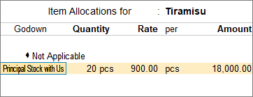

    2. Select the Godown in which the options Third party Stock with us is set to Yes.
      stock-received
      Record stock items received for consignment sale

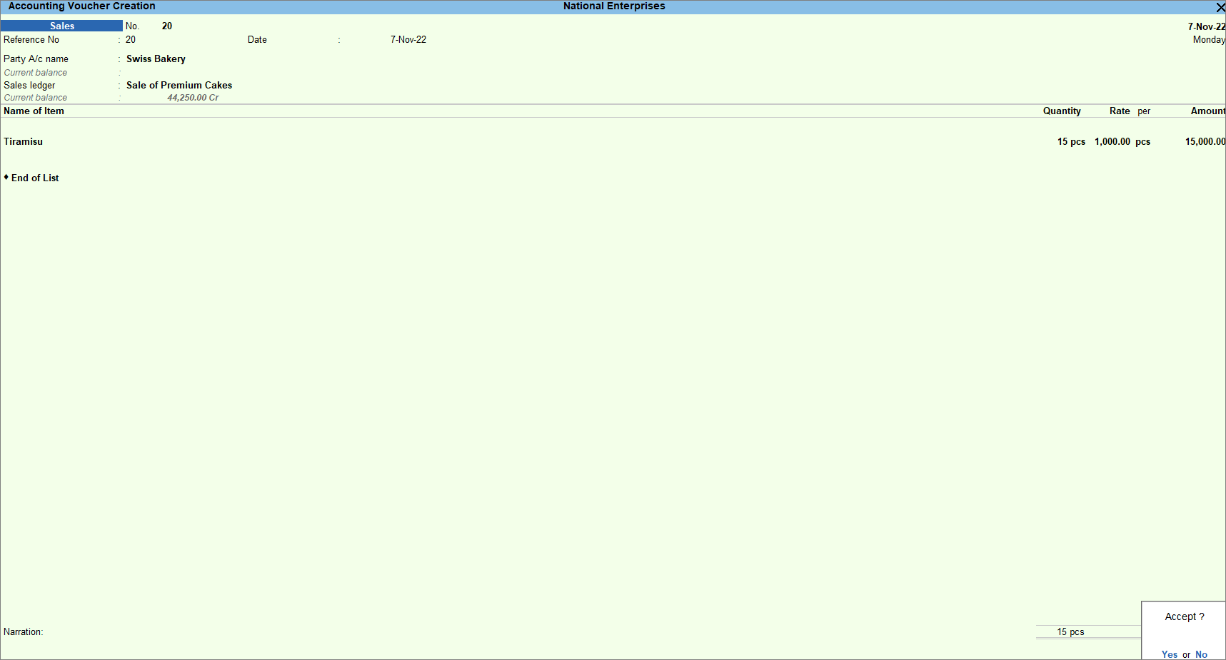

Record sales of goods received from the principal
After you have sold the goods you have received from the principal, you need to record the sales in your books. In TallyPrime, you can record the sale of goods as usual.
    1. Party A/c Name: Select Cash or Bank for cash sales and the party name for credit sales and press Enter.
    3. Party Details: You can update the buyer details while recording the transaction and print the same in the invoice.
    4. As always, you can press Ctrl+A to save and proceed.

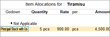

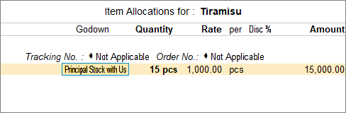

      Sale-of-goods-of-principal

  2. Provide stock item details.
    2. Select the Godown in which the option Third party Stock with us is set to Yes.
      goods-returned-to-principal
    4. Press Ctrl+A to accept the screen. The material out voucher screen appears.
      Goods return to the principal
  3. As always, press Ctrl+A to save.

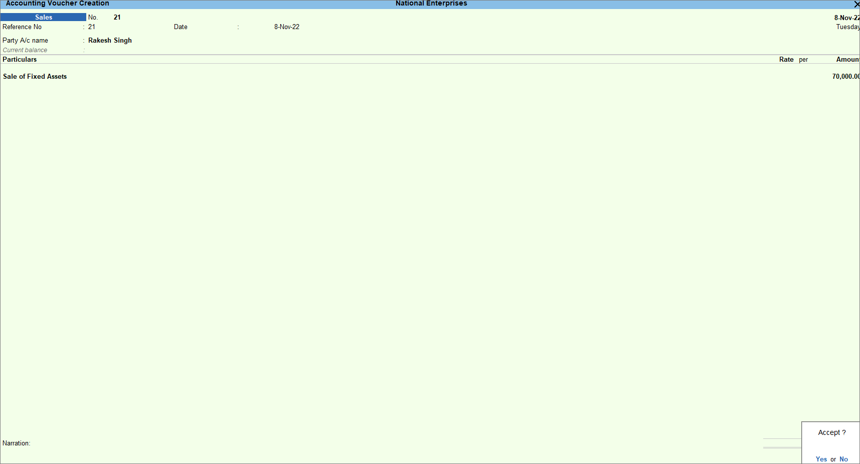

Record Sale of Fixed Assets
You can sale your Fixed Assets if the fixed asset is worn out or you want to replace it with a better asset. While selling fixed assets, you can record the sales transaction as usual in TallyPrime. You can also record a journal voucher to adjust the profit or loss on the sale of fixed assets.
For example, you have purchased the fixed asset for 5,00,000, and the depreciation was accounted for as 4,60,000. The value of the fixed asset was 40,000. It was then sold for 50,000 (at a profit of 10,000).
      Alternatively, Gateway of Tally > Voucher > press F8 (Sales).
    2. Press Ctrl+H (Change Mode) > select Accounting Invoice.
    1. Party A/c Name: Select Cash or Bank for cash sales and the party name The Dispatch Details screen appears.
  3. Provide the fixed asset details.
    1. Select the fixed assets ledger grouped under Sales Accounts.
    2. Enter the amount.
      Sale of fixed assets
  4. Provide Narration, if needed. As always, press Ctrl+A to save.
  5. Print the invoice.

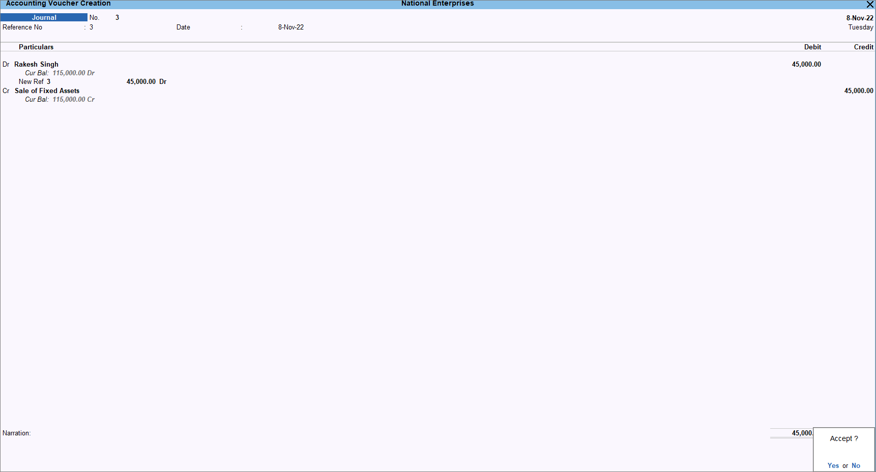

Record Journal Voucher to Adjust Profit or Loss on Sale of Fixed Assets
After recording the sale of fixed assets, you can transfer the amount from the sales ledger to the fixed assets ledger and account for the profit or loss.
In this section
Account for profit on sale of fixed assets
If the sale value is more than the value of the Fixed Asset then you can record the profit on the sale of such Fixed Asset. Using the income ledger, you can account for the profit made on the sale of fixed assets.
For example, the value of the fixed asset after depreciation is 40,000. You have sold it for 50,000. You can transfer 40,000 to the fixed assets account and 10,000 to the income account.

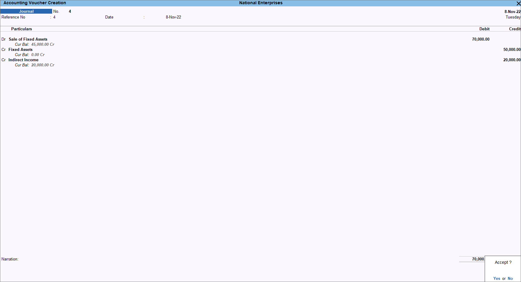

  1. Press Alt+G (Go To) > Create Voucher > press F7 (Journal).
    Alternatively, Gateway of Tally > Voucher > press F7 (Journal).
  2. Record the transaction.
    1. Debit the sales ledger and enter the sale value.
    2. Credit the fixed assets ledger and enter the asset value.
    3. Credit the indirect income ledger. The amount (profit) appears automatically.
      Record profit on sale of fixed assets

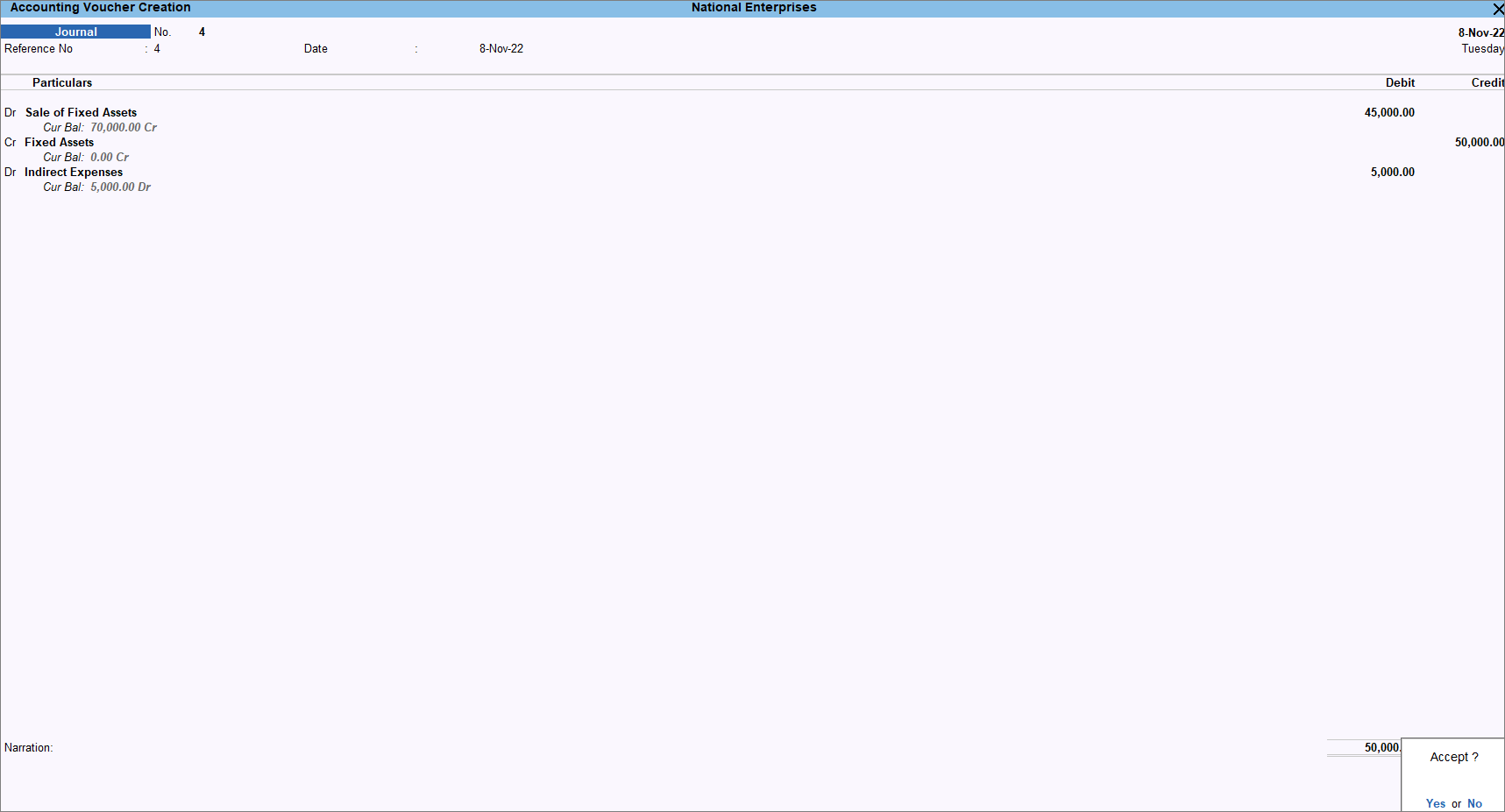

Account for loss on sale of fixed assets
If the sale value is less than the value of the Fixed Asset then you can record the loss on the sale of such Fixed Asset. Using the expense ledger, you can account for the loss incurred on the sale of fixed assets.
For example, the value of the fixed asset after depreciation is 50,000. You have sold it for 40,000. You can transfer 50,000 to the fixed assets account and 10,000 to the expense account.
    2. Debit the indirect expense ledger, and enter the amount (loss).
    3. Credit the fixed assets ledger. The asset value appears automatically.
      Record loss on sale of fixed assets
