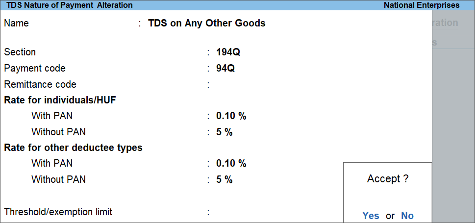

TDS Nature of Payment
  1. Gateway of Tally > Create/Alter > type or select TDS Nature of Payments > select any Nature of Payment (if you are altering any existing Nature of Payment) > and press Enter.
    Alternatively, press Alt+G (Go To) > Create Master/Alter Master > type or select TDS Nature of Payments > select any Nature of Payment (if you are altering any existing Nature of Payment) > and press Enter.
    The TDS Nature of Payment Creation/Alteration screen appears.
    TDS Nature of Payment Alteration Screen
  2. Enter the required fields in the TDS Nature of Payment Creation/Alteration screen, as applicable.
  3. Press Y to accept the screen. You can also press Enter to save the master screen.

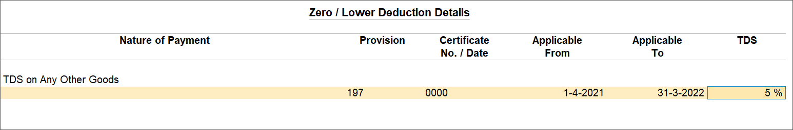

      1. Set the option for Set/Alter Zero/Lower Deduction to Yes. The Zero/Lower Deduction Details screen appears.
      2. Provide the details in Zero/Lower Deduction Details screen:
        • Select the Nature of Payment configured at a higher rate from the List of Nature of Payments.
          You can create Nature of Payment on the fly by pressing Alt+C.
        • Select 197 Lower Deduction from the List of Provisions.
        • Provide a unique certificate number under Certificate No./Date.
          We would recommend using certificate number as ‘0000’, so that the future migration will be taken care of automatically.
        • Enter Applicable From date.
        • Enter Applicable To date.
        • Enter the TDS at twice the rate as specified under the relevant category or at a rate of 5%, whichever is higher.
          TDS on Higher Tax Rate in Zero/Lower Deduction Details Screen
          Ctrl+Enter on the master will open the master on the fly so that you can check the specified TDS rate before applying.
        • Select End of List twice to return to the Ledger screen.

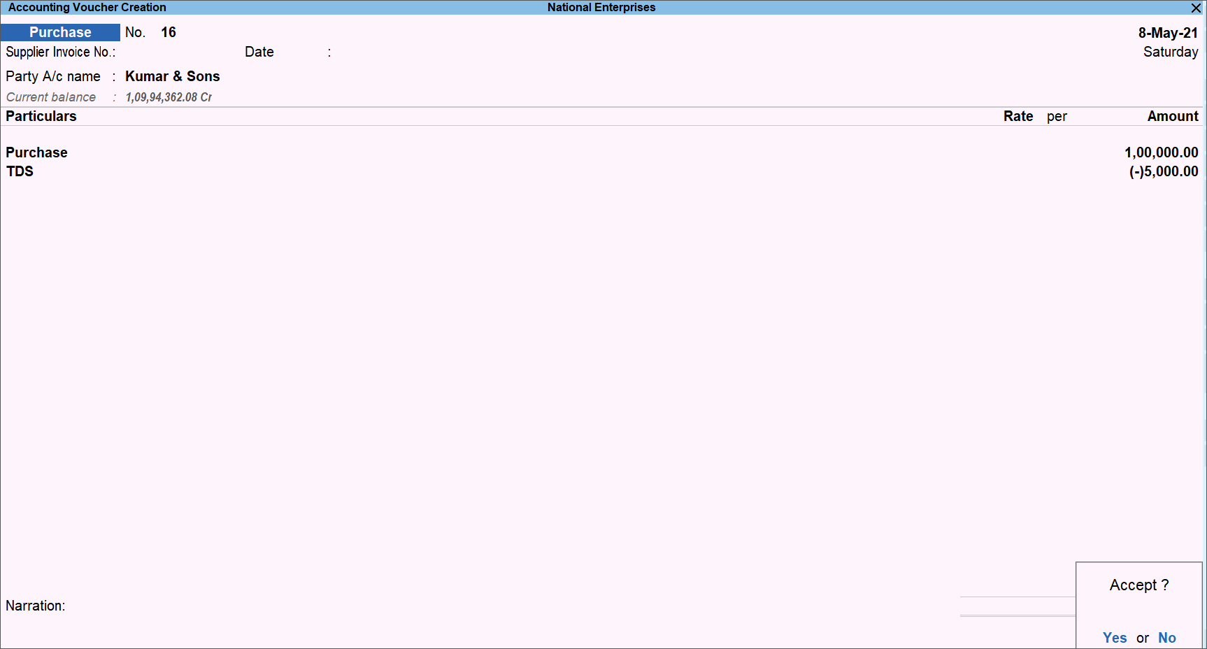

  1. While recording a Purchase voucher, enter the Amount. The TDS Nature of Payment Details screen appears.
    If you want to know how to record a Purchase voucher, then click here.
  2. Select the appropriate Nature of Payment from the List of TDS Nature Of Pymt. The Assessable Value will be prefilled from the Purchase voucher screen.
  3. Select TDS from the List of Ledger Accounts. It will deduct the TDS amount accordingly.
    The TDS will be calculated based on the applicable tax rate configured at twice the rate as specified under the relevant category or at a rate of 5%, whichever is higher.
    Purchase Voucher with TDS on Higher Tax Rate

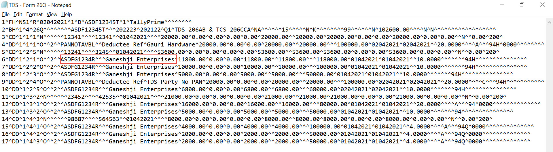

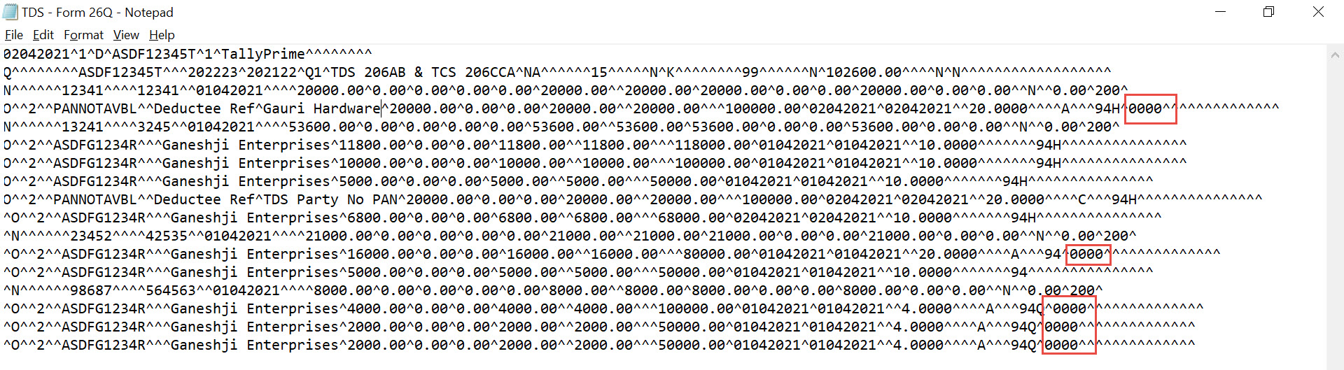

You must have exported the .text file for the respective return forms, as applicable to your business. All you need to do is identify the transactions with 0000 as the certificate no. and then replace the letter A with U or J, as applicable, so that you can file returns with the remark value required by the government. Follow the steps given below to make the changes in the .text file before filing the returns.
  1. Open the .text file.
  2. Identify the transactions recorded for the Party.

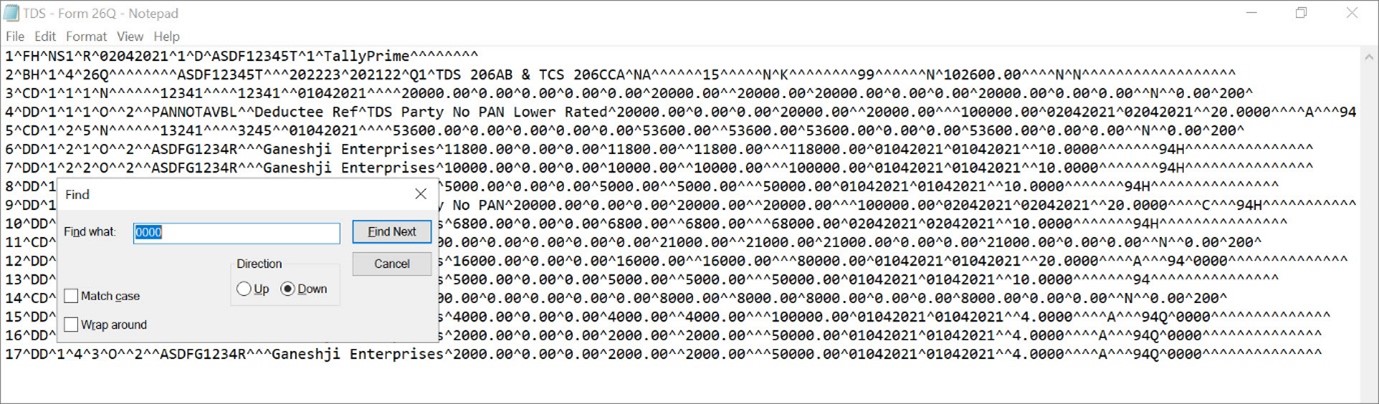

    1. Press Ctrl+F.
    2. Under Find what: type 0000 and press Enter or click Find Next.
      Finding Transactions with 0000 in Form 26Q in TallyPrime.
    3. Identify the transactions with 0000 at the end of the row.
      Identifying the Transactions Recorded with the Party Ledger Configured with Certificate Number and Date in TallyPrime.
      If the Zero/Lower Collection Details screen of the Party ledger Party ledger is not configured with 0000 as the Certificate No., then press Ctrl+F, enter Party’s PAN or Name of the Party, and press Enter to identify the PAN or Party.
      Identifying Party with PAN.

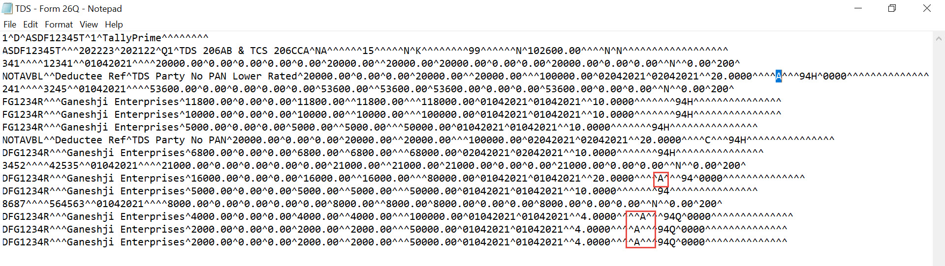

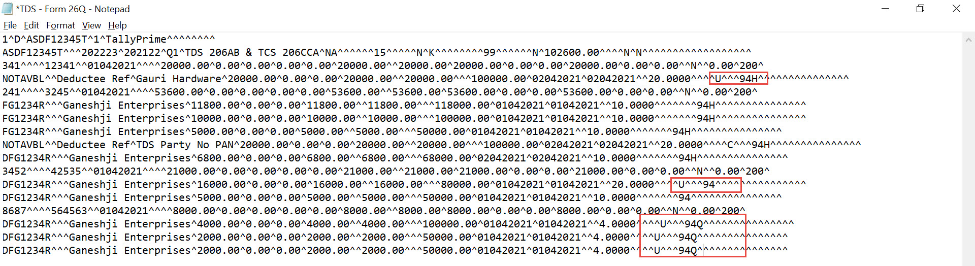

  3. In the identified transactions, replace the alphabet A with:
    • U for Form 26Q.
    • J for Form 27Q.
      Before replacing A with U, the .text file appears as shown below.
      Transactions with Alphabet A Highlighted in Form 26Q in TallyPrime.

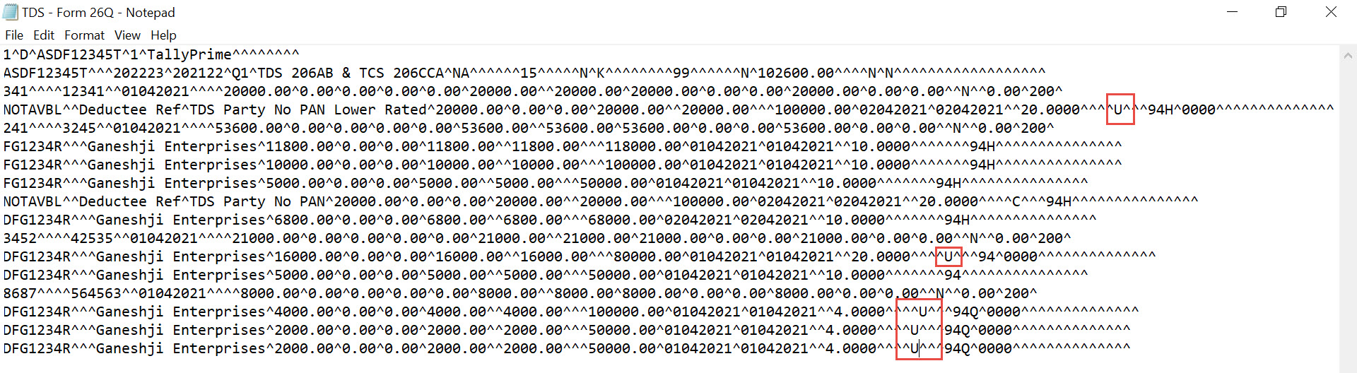

      After replacing the alphabet A with U, the .text file of the form will appear as shown below.
      Alphabet A Replaced with Alphabet U in Form 26Q in TallyPrime.
  4. After entering the applicable remark value, remove 0000 from the rows.
    .text file before removing 0000 appears as shown below.
    Before Removing 0000 from the Row in the Text File.
    .text file after removing 0000 appears as shown below.
    After Removing 0000 from the Row in the Text File.
