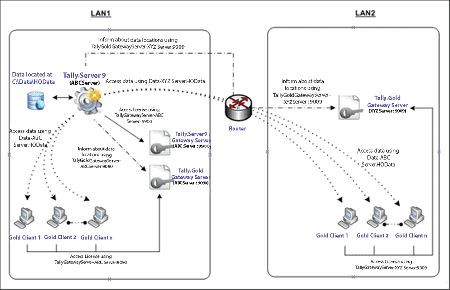

Large-sized businesses need to have better administration of resources within a network along with higher security. For this, they have multiple Subnetworks running, based on different requirements like department segregation. Hence, while User-set A and User-set B are on different Subnets in the same LAN, but they access the same data.
Scenario
The Tally.Server 9 license is deployed on a server machine present in a Subnet (say LAN1), by activating the license using the newly installed Tally G ateway S erver. A different Tally G ateway s erver, running in the same machine, is used for the deployment of Tally.ERP 9 Gold.
In a different Subnet, say LAN2 (within the organisation), a Tally G ateway S erver is used for the deployment of a different Tally.ERP 9 Gold, which also requires to access the data available in LAN1.
Existing Set Up
LAN1 set up
● Tally Gateway Server used for Tally.ERP 9 Gold deployment is installed on the server machine (ABC Server) on LAN1 and is running at the port 9090 .
● The data resides on the same server machine ( ABC Server ) on LAN1 at C:\Data\HOData .
● Tally.Server 9 is to be installed on the same server machine ( ABC Server ) on LAN1.
● A different Tally Gateway Server is installed on ABC Server (LAN1) to serve the license for Tally.Server 9.
LAN2 set up
● A different Tally Gateway Server used for Tally.ERP 9 Gold deployment is installed on a server machine ( XYZ Server ) on LAN2 and is running at the port 9009 .
Steps for Deployment
When you install Tally.Server 9 for a new user (ABC Server on LAN1)
● Enter Data in the field in Data name .
● Specify C:\Data\HOData as the Data location .
● Enter ABC Server and 9090 in the Server IP/Name and Port fields respectively, in the existing Tally.ERP 9 Gold Gateway Server.
Once the IP:Port configuration is made, Tally.Server 9 will inform the Tally.ERP 9 Gold Gateway Server present in LAN1 about the location of the data, and all the Tally.ERP 9 Gold Clients in LAN1 will be able to access the data from the Tally.ERP 9 Gold Gateway Server.
To inform the Tally.ERP 9 Gold Gateway Server deployed (XYZ Server on LAN2) about the location of data present in ABC Server (LAN1)
● Open Tally.Server Monitor.
● Specify the IP address of the Gold license of Tally.ERP 9 is deployed in XYZ Server on LAN2 and the port as 9009 , in the Tally.ERP 9 Gold Gateway Server Details section.
For more information on Tally.Server 9 installation, click here .
Once the IP:Port configuration is made, Tally.Server 9 in LAN1 will inform the Tally.ERP 9 Gold Gateway Server present in LAN2 about the location of the data, and all the Tally.ERP 9 Gold Clients in LAN2 will be able to access the data from the Tally.ERP 9 Gold Gateway Server.
