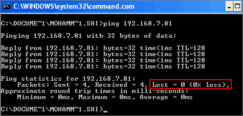

If the Local Area Network Connectivity shows Yes, check if the client is communicating with the server computer.
  1. Go to the Start menu > Run > Command Prompt.
  2. Enter Ping <IP Address>. For example, enter Ping 192.168.7.81. If the network is connected, you will get a response as shown below.
  3. Click the close button to exit.
    Check network connectivity
