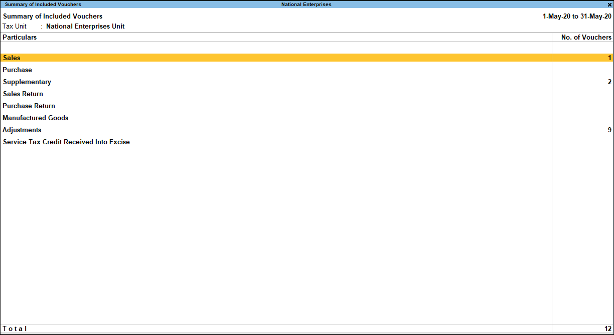

View the Summary of Included Transactions screen
Select Included Transactions and press Enter. The Summary of Included Vouchers screen appears as shown below:
The transactions are grouped under the following categories:
  • Sales: All excise sales transactions with one of the following selected as nature of removal:

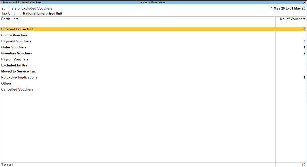

View the Summary of Excluded Transactions screen
Select Excluded Transactions and press Enter. The Summary of Excluded Vouchers screen appears as shown below:
  • Different Excise Unit: It displays count of transactions which fulfils all requirements of Form ER1 but belongs to another excise unit.
  • Contra Voucher: As contra voucher will not be used for excise related transactions, the voucher is excluded.
  • Order Vouchers: Order vouchers such as sales order, purchase order, job work out order and job work in order will not have impact on financial statements nor will they be used for any excise transactions.
  • Inventory Vouchers: Inventory vouchers such as physical stock voucher, rejection in/out voucher, delivery note/receipt note, material in/out do not have excise implications and these vouchers are excluded.
  • Payroll Vouchers: Payroll and attendance vouchers which are used for maintaining employee records, processing salary, etc., are excluded.
  • Excluded by Users: This includes transactions which were intentionally excluded by users.

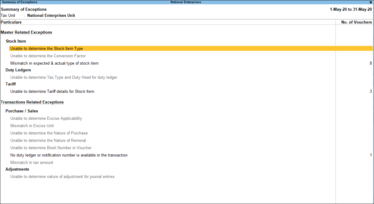

Summary of Exceptions
Transactions with missing or mismatched information in transactions will be displayed under Uncertain Transactions.
View the Summary of Exceptions screen
Select  Uncertain Transactions and press Enter. The Summary of Exceptions screen appears as shown below:

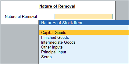

Unable to determine the Stock Item Type: If the option Excise Applicable has been set to Not Applicable in the stock item, then the Stock Item Type has not been defined. This exception can be resolved by setting the appropriate stock item type.
To set the stock item type:
  1. Press Enter on the transaction.
  2. Press Alt+S (Set Item Type).
  3. Select the Nature of Removal, as required.
  4. Press Esc.
  5. Press Alt+B (Save).
  6. Press Enter.

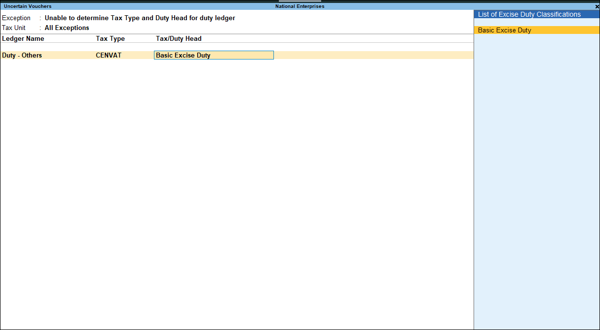

Unable to determine Tax Type and Duty Head for duty ledger: If the duty ledger selected in a transaction does not have the Type of Duty selected, and hence the Excise Duty Head is not selected, the transaction will be listed as an exception in this category. This exception can be resolved by defining the appropriate tax type and the duty head for the tax ledger.
To define the tax details
  2. Select the Tax Type.
  3. Select the Excise Duty Head. The Uncertain Vouchers screen appears as shown below:
  4. Press Enter.
  5. Press Esc.
  6. Press Alt+B (Save).
  7. Press Enter.
Alternatively, press Alt+H (Exclude Vouchers) from the Uncertain Vouchers screen to exclude the transaction.

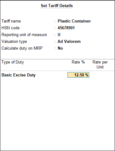

Unable to determine Tariff Details for Stock Item: If the tariff details for a stock item are not defined, the transactions in which the stock item is used will be categorised under Not able to determine Tariff details for Stock Item. This exception can be resolved by defining excise tariff details like HSN code, Reporting unit of measure, and Valuation type.
To set the excise tariff details
  1. Press Spacebar and select the transaction.
  2. Press Alt+S (Set Tariff Details).
  3. Define tariff details as shown below:
  4. Press Enter.

Mismatch in tax amount: This exception will appear for all Nature of Removal other than Special Rate for mismatch in,
  • Duty Rate, if the rate of duty configured in item master and provided in transaction are different
  • Assessable Value, wherein the duty amount against each duty head shown in the invoice is different
  • When the Nature of Removal is Export – Bond/LUT and SEZ – Bond/LUT and the transaction has different duty ledger with amount which is not ‘0’
This exception is applicable only for Home Clearance (Domestic, Captive Consumption – with duty), Export/Rebate, SEZ/Rebate were the duty is applicable.
To solve this exception
  1. Select Mismatch in tax amount,  and press Enter.
  2. Press Spacebar to select the transaction.
  3. Press Alt+J (Accept as is).

  3. Change the Rate of Duty in the invoice to match it with the rate predefined in masters or at company level. For this:
    1. Select the transaction and press Enter to view the Voucher Alteration screen.
    2. Place the cursor on Amount field and press Enter to display the Excise Details screen.
    3. Change the rate entered in the Rate of Duty field/column.
    4. Press Ctrl+A to accept.
