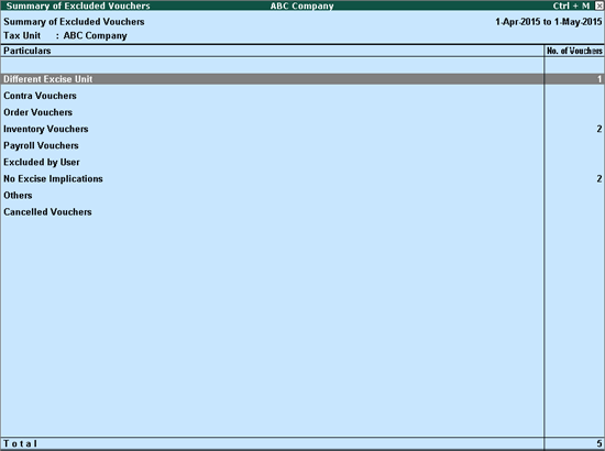

To view the Summary of Excluded Vouchers screen
● Select Excluded Transactions , and press Enter .
The Summary of Excluded Vouchers screen appears as shown below:
The transactions are grouped under the following categories:
Different Excise Unit
Contra Voucher
Order Vouchers
Inventory Vouchers
Payroll Vouchers
Excluded by Users
No Excise Implication
Others
Cancelled Vouchers

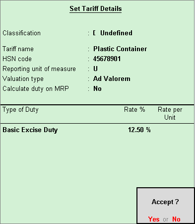

Tariff
Unable to determine Tariff Details for Stock Item : If the tariff details for a stock item are not defined, the transactions in which the stock item is used will be categorised under Not able to determine Tariff details for Stock Item. This exception can be resolved by defining excise tariff details like HSN code , Reporting unit of measure , and Valuation type .
To set the excise tariff details
1. Press Spacebar and select the transaction.
2. Click S : Set Tariff Details .
3. Define tariff details as shown below:
4. Press Enter .
