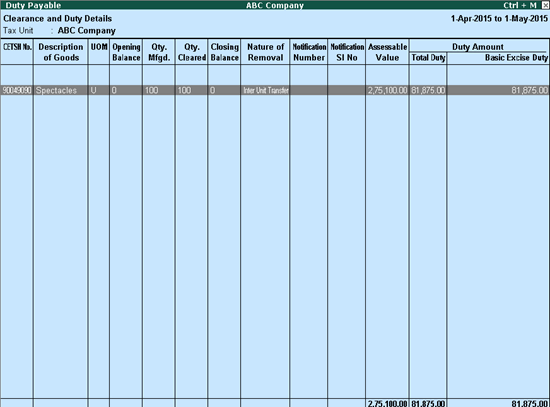

Duty Payable
The assessable value and duty value of transactions recorded by selecting the following Natures of Removal appears here.
● Home Clearance with nature of removal as Captive Consumption, Domestic, Special Rate and Exempt.
● Exports/LUT
● Export/Rebate
● SEZ/LUT
● SEZ /Bond
● SEZ/Rebate
To display duty break-up
1. Press Spacebar to select the required Nature of Removal .
2. Click F7: Duty Breakup .
The Duty Payable report appears as shown below:
