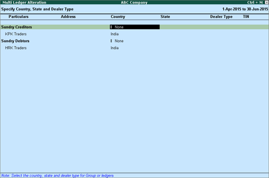

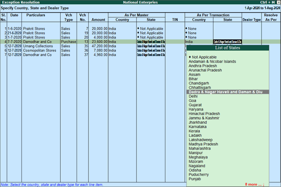

Country, state and dealer type mismatch/not specified
Displays the count of transactions where,
● Country/state is not selected in the party ledger master,
● State selected in transaction and party ledger are different, or
● Nature of transaction is not derived.
To resolve this exception
1. Select the exception Country, state and dealer type not specified/mismatch .
2. Press Enter . All the transactions of the exception type are displayed. The Exception Resolution screen appears as shown below:
3. Select the country, state  or dealer type for each transaction.
4. Press Ctrl+A to accept.
Note:
♦ Click X : Exclude Vouchers to exclude the voucher from forms and annexures.
♦ Ladakh is listed in the State field in Release 6.5.5 and later versions.
♦ Dadra & Nagar Haveli and Daman & Diu is listed in State field in Release 6.6.3 and later versions.

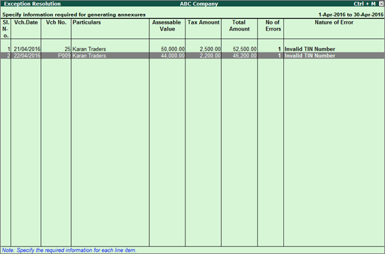

Information required for generating annexure not provided
Displays the count of transactions excluded from annexures due to incomplete information required for annexures. The button Exception Types is provided to resolve all party ledger level or voucher level corrections from a single screen.
To resolve all exceptions without having to go from one exception type to another
1. Select Information required for generating annexure not provided .
2. Press Enter to display Exception Resolution screen with list of vouchers with mismatch/incomplete information.
Note: Based on the state specific tax structure, the columns are displayed. The column:
♦ Additional Tax appears for Gujarat and Uttar Pradesh.
♦ Surcharge appears under each taxable transaction for Punjab and Haryana.
♦ Cess under each taxable transaction for Kerala VAT.
3. Select any voucher and press Enter to display the Annexure exceptions(s) screen, as shown below:
Note: Based on the state specific TIN code, the first two digits are prompted in the message displayed under Validation Rules .
4. Enter the missing information or update the incorrect details, and press Enter to return to the Exception Resolution screen .
5. Select the next voucher to update the details required for annexures and continue.

Drill down from this column to view information missing/mismatch at ledger master level. You can provide the required details at ledger group level to update all ledgers in the group or at individual ledger level. By providing required information at leger master level, all voucher level exceptions resulting from that ledger are resolved.
1. Click L : Ledger Exceptions .
2. Navigate to required exception type and press Enter from Total Masters column to display Multi Ledger alteration screen, as shown below:
3. Select Country , State , and Dealer Type .
4. Enter TIN for a dealer (not allowed at group level).
5. Press Ctrl+A to accept.

Drill down from this column to view information missing/mismatch in the ledger at voucher level. You can provide the required details for each transaction.
2. Navigate to required exception type and press Enter from Total Vouchers column to display Exception Resolution screen, as shown below:
3. Enter TIN for each dealer .
4. Select Country , State , and Dealer Type .
Note : Dadra & Nagar Haveli and Daman & Diu is listed in State field in Release 6.6.3 and later versions
