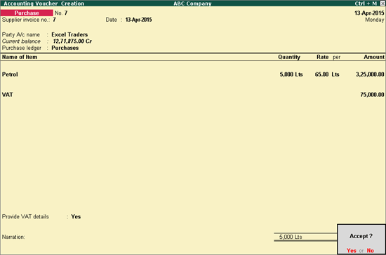

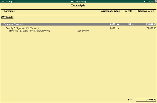

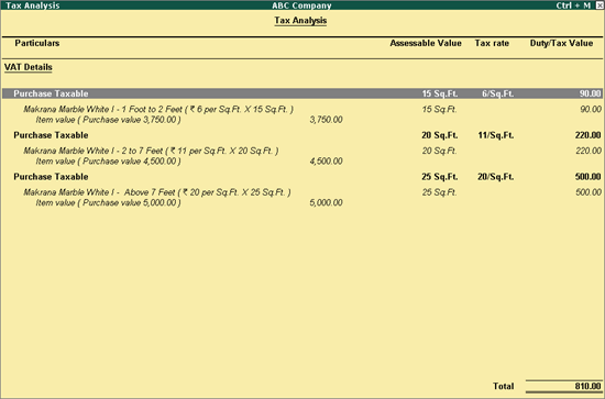

Taxable Purchases - VAT Calculation Based on Quantity
1. Go to Gateway of Tally > Accounting Vouchers > F9: Purchases .
2. Enter Supplier Invoice No. and Date .
3. Select the party ledger in Party's A/c Name option.
4. Select a common purchase ledger in which the option Is VAT/CST Applicable? is set to Applicable , and the option Set/Alter VAT Details? is set to No .
5. Select the required stock item whose VAT rate per unit is specified in the stock item.
6. Define the VAT rate per unit for the stock item as shown below:
Note: To select the calculation type for VAT rate in the stock item, ensure that the option given below is set to Yes in the Company VAT Details screen:
♦ Enable VAT calculation quantity for Assam, Jharkhand, Madhya Pradesh, Punjab, Rajasthan, and West Bengal.
♦ Enable VAT calculation on stock item rate for Delhi.
7. Enter the Quantity and Rate for each stock item.
8. Select the common VAT ledger.
9. Click A : Tax Analysis to view the Tax Analysis screen.
● Click F1 : Detailed to view the stock items. The Tax Analysis screen appears as shown below:
Note: The tax for each item is calculated based on the rate specified in the stock item master by selecting On Quantity as the Calculation Type .
● Press Esc to return to the purchase invoice.
10. Set the option Provide VAT details? to Yes . In the Statutory Details screen
● Enter the purchase details
● Press Ctrl+A to accept.
11. Press Enter to save.

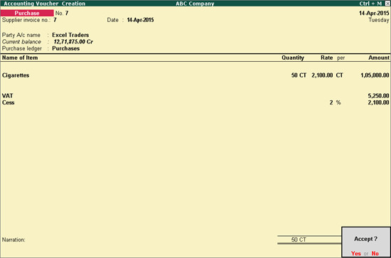

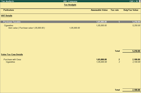

Taxable Purchases with Cess
Kerala VAT
To record purchases with VAT and cess
4. Select a common purchase ledger in which the option Is VAT/CST Applicable? is set to Applicable , and the option Set/Alter VAT Details? is not enabled.
5. Select the required stock item whose VAT rate is specified either at the stock group or stock item level. Enter the Quantity and Rate for the stock item.
6. Select the common VAT ledger. The ledger must be grouped under Duties & Taxes in which the options:
● Type of duty/tax is set to VAT .
● Percentage of Calculation (eg 5)? is set to 0.
7. Select the cess ledger .
8. Click A : Tax Analysis to view the Tax Analysis screen.
9. Set the option Provide VAT details? to Yes . In the Statutory Details screen
10. Press Enter to save.

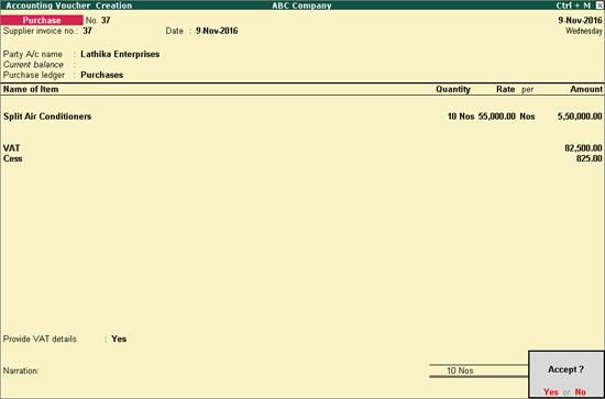

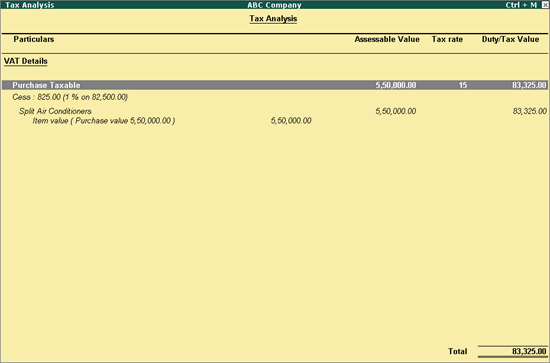

Uttarakhand VAT
9. Press Enter to save.
Note: Cess in Uttarakhand VAT is not calculated on the following:
♦ Other tax/duty ledgers and additional ledgers selected for expense/income enabled for apportionment to assessable value.
♦ Invoice configured with voucher class to display the stock item value inclusive of tax.
♦ MRP of stock items.

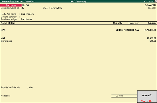

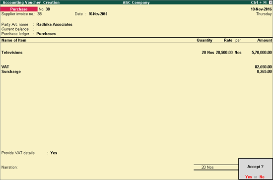

Taxable Purchases with VAT and Surcharge
Haryana VAT
To record purchases with VAT and surcharge

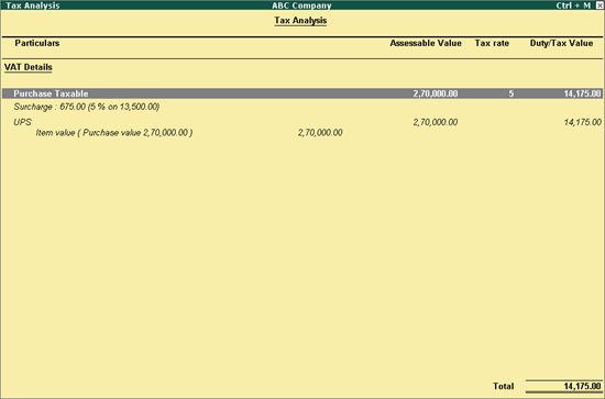

7. Select the surcharge ledger .
Punjab VAT
5. Select the required stock item whose VAT rate is specified either at the stock group or at the stock item level. Enter the Quantity and Rate for the stock item.

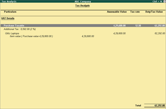

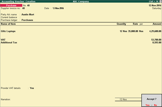

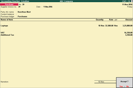

Taxable Purchases with Additional Tax
Gujarat VAT
● The ledger must be grouped under Duties & Taxes in which the options:
o Type of duty/tax is set to VAT .
o Percentage of Calculation (eg 5)? is set to 0.
7. Select the additional tax ledger .
o Click F1 : Detailed to view the stock items. The Tax Analysis screen appears as shown below:
o Press Esc to return to the purchase invoice.

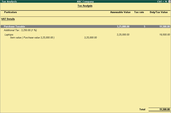

Uttar Pradesh VAT
o Enter the purchase details
o Press Ctrl+A to accept.
