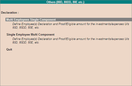

Other Deductions
1. Select either Others (80D, 80DD and 80E etc.) under Deductions under Chapter VI-A in Tax Configuration screen, and press Enter.
2. To add Others declaration for all employees, select Multi Employee Single Component , and follow the process explained in Investments - Multi Employee Single Component .
3. To add Others declaration for employees one by one, select Single Employee Multi Component, and follow the process explained in Investments - Single Employee Multi Component .

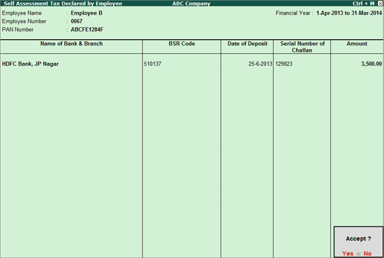

Self Assessment Tax Declared by Employee
1. Bring cursor, on Self Assessment Tax Declared by Employee in Tax Configuration screen, and press Enter .
2. Select the required employee, and press Enter .
3. Press Enter to save.
