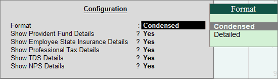

Configuration options in Payroll Statutory Summary
F12: Configure in the Payroll Statutory brings up a configuration sub-form using which the user can customise the display of content and appearance of the Computation report.
● Format : Select Detailed against this option to view the detailed report. Alternately, the F1: Detailed button on the button bar can also be used to view the detailed report.
● Show PF Details : Set this option to Yes to view the PF computation details.
● Show ESI Details : Set this option to Yes to view the ESI computation details.
● Show PT Details : Set this option to Yes to view the PT computation details.
● Show TDS Details : Set this option to Yes to view the Income Tax computation details.
