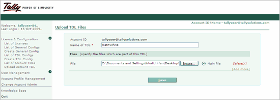

7. In Upload Account TDL Files screen
o Enter a valid name to the program files you want to upload in Name of TDL field.
o Click Browse .
o Select the required TDL program file(s) from the saved location.
o Check Main File to indicate the file selected is the primary resource file.
8. Click Save to upload the program file(s).

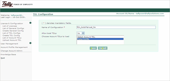

To create a TDL Configuration Pack from the Web Control Centre follow the steps shown:
In the Licensing & Configuration menu:
o Click Create TDL Config .
o Enter a valid name to the TDL Configuration Package in the Name of Configuration field.
o Permit or disallow the use of other TDL files available locally in the Allow local TDLs field.
o Select the required TDL programs uploaded from the list displayed in the Choose Account TDLs to load field.
o Click Save to create the TDL Configuration pack.

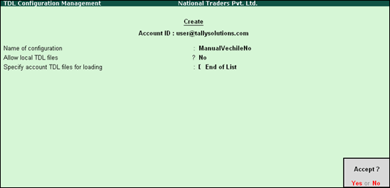

Create TDL Configuration Pack from Tally.ERP 9
1. Log in to the Control Centre using the Administrator’s Account ID and Password .
2. Click Tally.NET Account in the Control Centre screen.
3. Select the required Account ID in My Tally.NET Account(s) screen. The Control Centre screen for the selected account ID appears.
4. Click Licensing & Configuration .
5. Select the required site in the Licensing & Configuration screen.
6. Press Alt+C in the TDL Config field .
7. In the TDL Configuration Management screen:
8. Enter a valid name to the configuration package in Name of configuration field.
9. You may permit or disallow the use of other TDL files available locally in Allow local TDL files field.
10. Select the required TDL programs uploaded in Specify Account TDL files for loading field.
11. Press Ctrl+A to save the TDL Configuration pack.

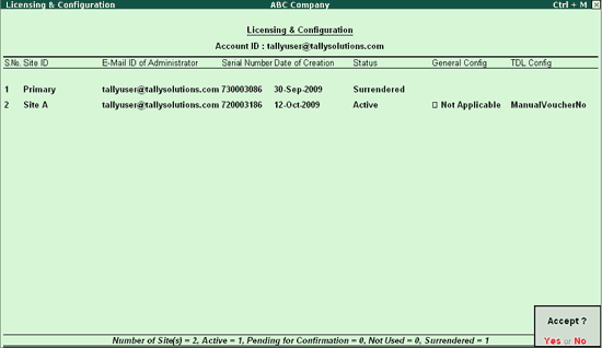

Link TDL Configuration Pack
1. Select the respective site in the Licensing and Configuration screen.
2. Select the required TDL Configuration Pack from the List of TDL Configs in the TDL Config field.
3. Press Enter to link the TDL Configuration Pack to the selected site.
