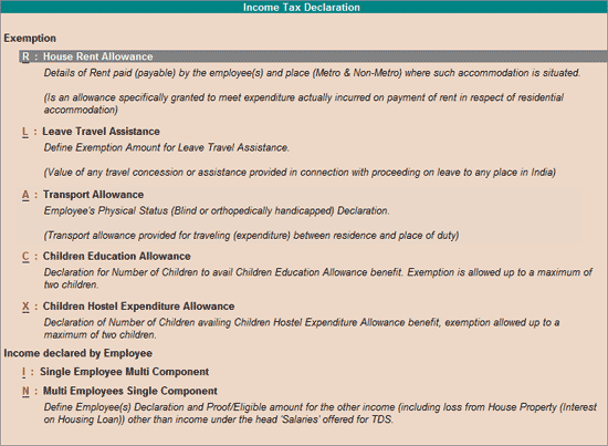

The employee can provide the Exemption and Deduction details to the employer, and these details can be entered in the system as employee Declaration by following the process given below:
● Go to Gateway of Tally > Payroll Info. > Income Tax Details > Declarations
You can select the required exemption and investments, and enter the employee declarations details.

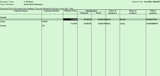

Declare House Rent Allowance
1. From the Income Tax Declaration screen, select House Rent Allowance , and press Enter .

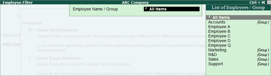

2. Select the required Employees or All Employees or an Employee Group.
3. In the House Rent Declaration screen:
● In the Effective From field, specify the date from when rent payment commenced.
● In Rent Declared Amount field, specify the amount the employee has declared as rent.
● In Rent Proof Amount field, specify the amount associated with the proof of rent paid the employee has submitted.
● In Place of Residence , select Metro or Non-Metro based on the city.
● In Name of Landlord column, specify the name of the landlord of the house rented by the employee.
● In the PAN of Landlord column, specify the PAN of the landlord or select Government or Non-resident, as applicable.
Note: Metro should be selected for Delhi, Mumbai, Kolkata and Chennai. For all others cities, Non-Metro should be selected.
4. Press Enter to save.
Similarly, the HRA details can be entered for an individual (one employee).

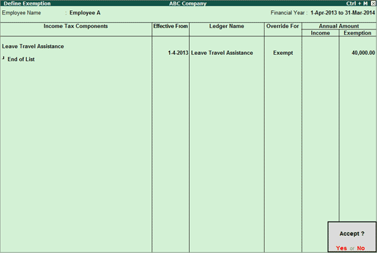

Leave Travel Assistance
1. From Income Tax Declaration screen, bring cursor on Leave Travel Assistance and press Enter .
2. Select the required Employee.
3. In the Leave Travel Assistance screen,
● In the Effective From field, specify the date when the LTA becomes applicable.
● In the Ledger Name field, select the Leave Travel Assistance ledger.
● By default, the Override for field is set to Exempt .
● In the Exemption Amount field, specify the LTA amount that is exempted from Income Tax.

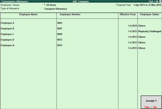

Declare Transport Allowance
1. From Income Tax Declaration screen, select Transport Allowance and press Enter .
2. Select the required Employees or All Employees, or an Employee Group .
3. In the Transport Allowance screen,
● In the Effective From field, specify the date from when the Transport Allowance becomes applicable.
● Select the Employee Status as Physically Challenged or Others.
Note: Employee Status will be used for Transport Allowance exemption limit.

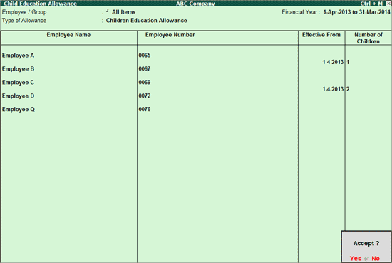

Declare Children Education Allowance
1. From Income Tax Declaration screen, select Children Education Allowance and press Enter .
2. Select the required Employees or All Employees or an Employee Group .
3. In the Children Education Allowance screen,
● In the Effective From field, specify the date from when the Children Education Allowance becomes applicable.
● In the Number of Children field, enter the number of children each employee wants to cover under this declaration.  You can enter a value of 1 or 2 in this field.

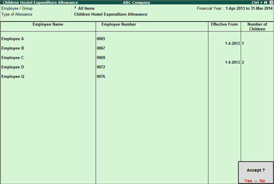

Declare Children Hostel Expenditure Allowance
1. From Income Tax Declaration screen, select Children Hostel Expenditure Allowance and press Enter .
2. Select the required Employees or All Employees , or an Employee Group.
3. In the Children Hostel Expenditure Allowance screen,
● In the Effective From field, specify the date from when the Children Hostel Expenditure Allowance becomes applicable.
● In the Number of Children field, enter the number of children that the employee wants to cover in this declaration. You can enter a value of 1 or 2 in this field.

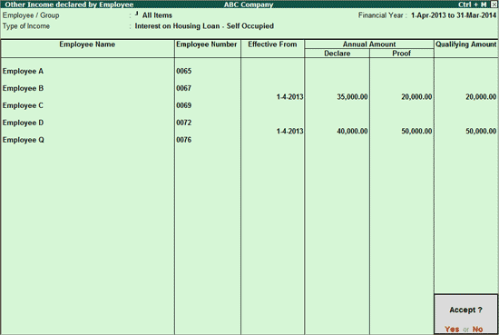

Income Declared by Employee - Single Employee Multi Component
Under this head, you can define employee(s) declarations and proofs/eligible amount for the other incomes such as House Property, other sources and Interest on housing Loan, if the premises is self occupied.
1. Select Income Declared by Employees - Single Employee Multi Component , and press Enter.
2. From the List of Employees, select the required employee.
3. Select the Particulars of Income Other than Salary - Income from House Property from the List of Other Income.
4. Specify the Effective From date.
5. Specify the Details of Income from House Property . The system computes the income from house property based on the information provided.
Similarly, you can select the other incomes to be declared.
6. Press Enter to save.

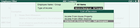

Income Declared by Employee - Multi Employees Single Component
1. Select Income Declared by Employees - Multi Employees Single Component , and press Enter.
2. From the List of Employees , select the appropriate Employee Group .
3. Select the Type of Income from the List of Incomes.
5. In Annual Amount column, specify the Declare and Proof amount. The system will then display the qualifying amount.
6. Press Enter to s ave.

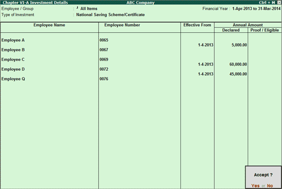

Declaring Investments U/s 80C, 80CCF, 80CCG, etc. - Multi Employees Single Component
1. From Income Tax Declaration screen, select Multi Employees Single Component under Investments (U/s 80C, 80CCF etc.) and press Enter .
2. Select the All Items from the List of Employees , and press Enter.
3. Select the required Investment from the List of Investments press Enter.
4. In the Investment Declaration screen,
● In the Effective From field, specify the date when these investments become applicable.
● In the Declared Amount field, specify the amount declared for the selected investment.
● In the Proof/Eligible Amount field, specify the details of the amount associated with the proof submitted by the employees.
5. Press Enter to save.

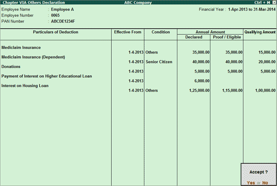

Declaring Other Deductions under Chapter VI-A - Single Employee Multi Component
1. From Income Tax Declaration screen, select Single Employee Multi Component under Others (U/s 80D, 80DD, 80E etc.) and press Enter .
2. From the List of Employees , select the appropriate employee, and press Enter
3. In the Chapter VIA Others Declaration screen,
● Under Particulars of Deduction , select the required Deduction from the List of Investments
● In the Effective From field, specify the date when the deductions are applicable.
● In the Condition field, select the appropriate value from the l ist (such as Others, Senior Citizen or Severe Disability ) based on the information provided.
● In the Declared Amount field, specify the amount declared for the respective investment.
● In the Proof/Eligible Amount field, specify the details of the amount associated with the proof submitted by the employee.
● The Qualifying Amount field displays the actual amount which is allowed as deduction from actual salary.
Note: For Mediclaim Insurance taken for dependant parents in addition to self, the maximum Qualifying Amount is Rs. 40,000 [ Self (if Senior Citizen) Rs.20000 + Parents (Senior Citizens) Rs. 20000 ).
