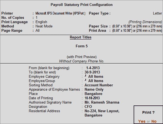

1. Go to Gateway of Tally > Display > Payroll Reports > Statutory Reports > Employee State Insurance > Form 5 .
The Print Configuration for the ESI Form 5 is displayed as shown:
● The required period can be specified in the From and To fields. By default the values are pre-filled with the Contribution Period based on the last data entry date.
● Employee Category : You can select the required Cost Category when there is more than one Payroll/Cost categories.
● Employee/Group : You can print the report for a specific group or All Items.
● Sorting Method: Select the required Sorting Method from the list.
● Appearance of Employee Names: Select the required display Name style name
● Place : The name of the place where the organisation is located has to be provided against this field to print the same in the Form 5.
● Date of Printing : The user can specify the desired date of printing, by default the actual date of printing will be selected.
● Authorised Signatory : Name of the signing authority should be entered in this field.
● Designation : The designation of the authorised signatory in Form 3 needs to be entered in this field.
● Residential Address : Enter the residential address of the authorised signatory in this field.

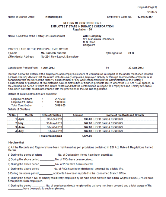

The printed Form 5 – page 1 is displayed as shown:
● Name of Branch Office : This displays the ESI branch office for the Company as specified in the F11: Statutory & Taxation screen while enabling Payroll Statutory features.
● Employer’s Code No. : This displays the ESI Code of Employer as specified in F11: Statutory & Taxation screen while enabling Payroll Statutory features.
● Name & Address of the Factory/Establishment : This displays the Company name & address.
● Employer’s Code : This displays the ESI Code allotted to Employer as specified in the F11: Statutory & Taxation screen while enabling ESI.
● Particulars of Principal Employers (Name, Designation and Residential Address) are printed as specified in the Print Configuration screen.
● Period From and To is printed as specified in the Print Configuration screen.
● Total ESI amount contributed with the break-up of Employer’s share and Employees’ share is displayed based on the calculations.
Column Details in table
Column Name
Description
Sl. No.
Displays the serial no.
Month
Displays the Month name for which the ESI payment is made.
Challan Dates
Displays the Challan dates for the ESI payments.
Amount
Displays the Challan amount for ESI Payments.
Name of the Bank and Branch
Displays the name of the bank and branch code as specified in the Challan details screen.
● Place : The Name of the place as specified in the Print Configuration screen is displayed in this field.
● Date : The Date of Printing as specified in the Print Configuration screen is displayed in this field.
● Designation : The Designation of the signing authority is displayed in this field.
