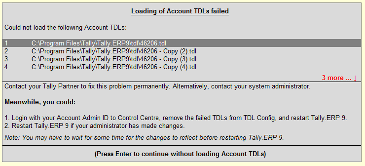

When incompatible TDLs are loaded as Account TDLs in Tally.ERP 9, it shows a message as shown below.
This occurs when Tally.ERP 9 is unable to read the loaded TDL files. To solve this problem, you need to do the following:
● Unlink the unreadable TDLs from the TDL configuration .
Or
● Unlink the TDL Configuration from the respective site and create a fresh configuration pack .
