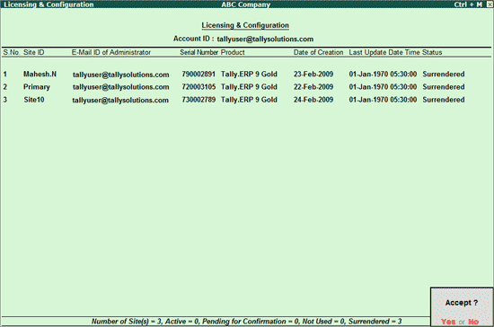

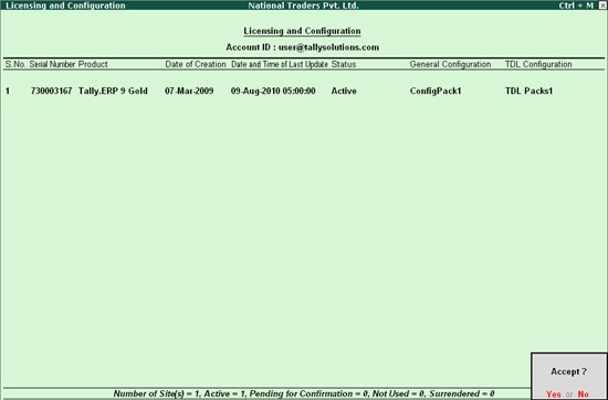

1. Select License Management in the Control Centre screen under Licensing and Configuration . The Licensing and Configuration screen appears as shown:
The Licensing and Configuration screen displays the information related to each site/license serial number, the date on which the site was created, Date and Time of Last Update, and the product linked.

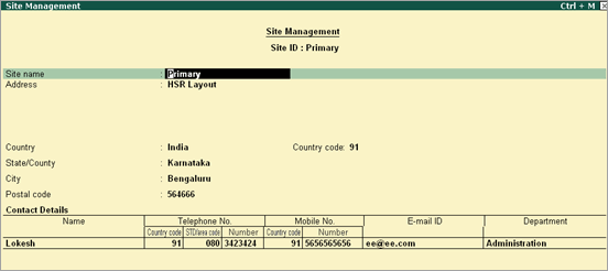

2. To change the site name, type the required site name in the Site name field in the Site Management screen as shown below:
The current state of a Site is displayed in the Status field.
3. Select the required status from the Status list.

Similarly, the account administrator can provide the site details, change the E-Mail ID of the Site Administrator or change the status for other sites within the account. The completed Licensing and Configuration screen appears as follows:

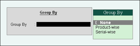

● F3: Group By : Press F3 to group information based on the Product (Tally.ERP 9, Tally.Server 9, etc.) or Serial Number .

o Group By - This option servers the same purpose as F3: Group By - the report will display information by categorising them based on the Products or Serial Numbers.

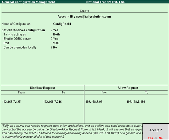

4. In the General Config field, press Alt+C to create configuration
5. The General Configuration Management screen appears
6. Enter the required configuration name in Name of Configuration field. The configuration parameters are saved with the configuration name provided in the account.
7. Set Set client/server configuration? to Yes to create a fresh set of configuration.
8. In Tally is Acting as field, select the required behaviour from the list of Client/Server list. Tally.ERP 9 will act as Server/Client/Both based on the parameter selected.
9. Set Enable ODBC Server to Yes , when you want to transfer data from any third party application to Tally.ERP 9 or Vice Versa.
10. Enter the required port number in Port field.
11. Set Can be overridden locally to Yes , when you want the above parameters to changed / modified by the site administrator locally.
12. In the Disallow Request section:
o Specify the required Server Name/ IP Address/URL in From field to deny a request from the Server/IP Address/URL.
o Specify the required Server Name/ IP Address/URL in To field to deny a request to Server/IP Address/URL.
13. In the Allow Request section:
o Specify the required Server Name/ IP Address/URL in From field to allow a request from the Server/IP Address/URL .
o Similarly, specify the required Server Name/ IP Address/URL in To field to allow a request to Server/IP Address/URL .
14. Press Enter to save the General Configuration .

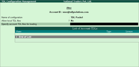

1. Press Alt + C in the TDL Config field to create a TDL configuration pack. The TDL Configuration Management screen appears.
o Specify the required configuration name in the Name of Configuration field.
o Set Allow Local TDLs to Yes , incase you want the user to load and execute local TDL’s.
o In Specify account TDLs for loading, select the required TDL from the List of Account TDLs . The required account TDLs are included by logging to your account from www.awsstgqa.tallysolutions.com.
2. Press Ctrl+A to accept the required TDL Configuration Package. The Completed Configuration package for respective serial number is appears as shown:
3. Press Enter to create the configuration package for your Account.

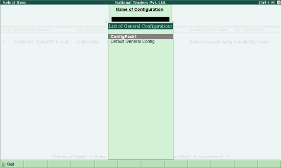

View/Alter General Configuration
1. Click F9: General Config or press F9 in the Licensing and Configuration screen. The Select Item screen appears.
2. Select the required configuration from the List of General Configurations .
The General Configuration Management screen appears.
You can make the required changes to the parameters in the General Configuration Management screen and save the changed parameters.

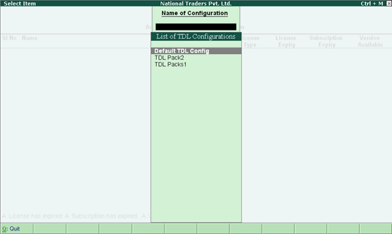

1. Click F8: TDL Config in the Licensing and Configuration screen. The Select Item screen appears.
2. Select the required configuration from the List of TDL Configurations .
The Configuration Management screen appears.
