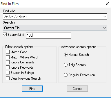

Normal Search
Here, when 'Set by Condition' is searched, the lines containing the expression 'Set By Condition' will be displayed in the search tab of the output window.

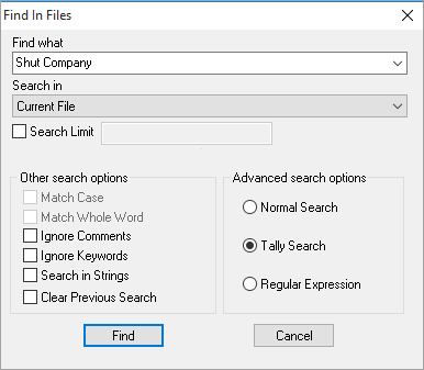

Tally search
Here, when 'ShutCompany' string is searched, the lines containing ShutCompany, Shut Company, AShutCompany, ShutCompanyTomorrow, etc., will be displayed in the search tab of the output window.

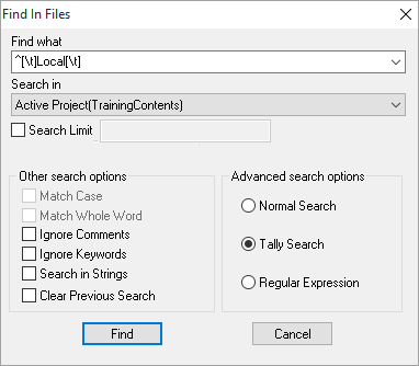

Regular Expression
Here, when the expression ^[\t]Local[\t] is searched, the lines wherein 'local' is the first word after a tab space, will be displayed in the search tab of the output window.
